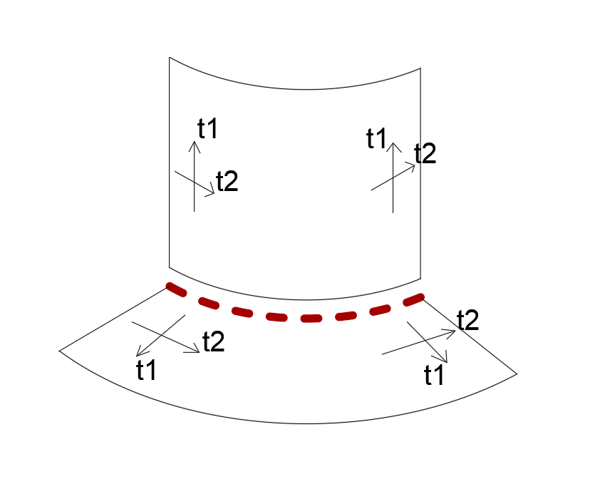

Thank you for your answer. I'll attach the image for a better question (the red line is my cylindrical hinge). When I have to prescribe a displacement is not a problem, I'll use the global coordinates, but when I have to insert the rotations ? it's very complicated, because I must insert the local rotations along the tangents (t1 and t2). t2 is free, but t1 ? Is there a solution ?
thanks for your available.
Thank you for your answer. I'll attach the image for a better question (the red line is my cylindrical hinge). When I have to prescribe a displacement is not a problem, I'll use the global coordinates, but when I have to insert the rotations ? it's very complicated, because I must insert the local rotations along the tangents (t1 and t2). t2 is free, but t1 ? Is there a solution ? thanks for your available.
