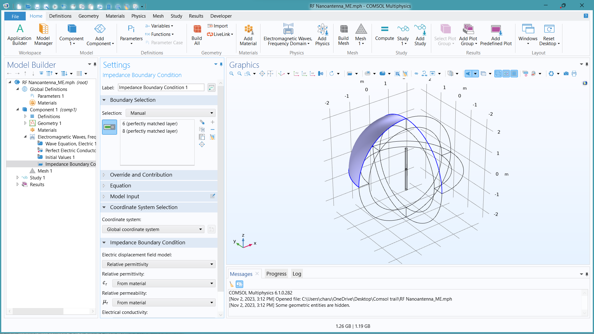

I tried to model dipole antenna (by following comsol guidelines). While following the steps, Impedance Boundary conditions, I can't select boundary from the geometry. The geometry selected looks like this. Please do tell me where I went wrong. .

Could it be that you have hidden the boundary you are trying to select? It looks that way on the screenshot you attached.

I think that Jeff is right. Another tip is to use the mouse wheel to move between all boundaries or domains in a 3D geometry that the mouse is pointing toward. It can make it easier to select hidden parts of the geometry.
