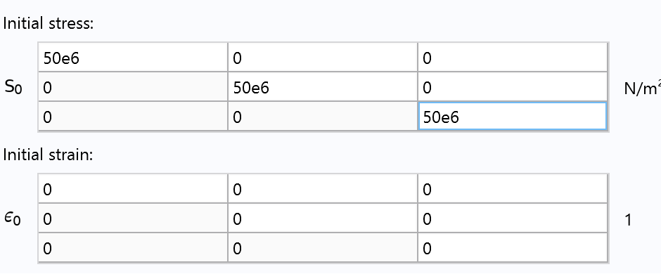

Hello Everyone, I hope you are doing fine. I just have quick question. I just want to define the inital interal stress in the layer in the solid mechnaics module. i calculated the internal stress in the layer is about 50 MPa after (deposition/oxidation). i need a quick answer that how i can define the internal stress in a layer at room temp. before starting the analysis. i hope i will get a suitable answer with many expert available on comsol platforum. have a good day. Regards

Right-click the Linear Elastic Material node and select the Initial Stress and Strain sub-node.
If there are multiple materials in the problem you will need to create a new Linear Elastic Material node for the material that has the initial stress.
Right-click the Linear Elastic Material node and select the Initial Stress and Strain sub-node. If there are multiple materials in the problem you will need to create a new Linear Elastic Material node for the material that has the initial stress.

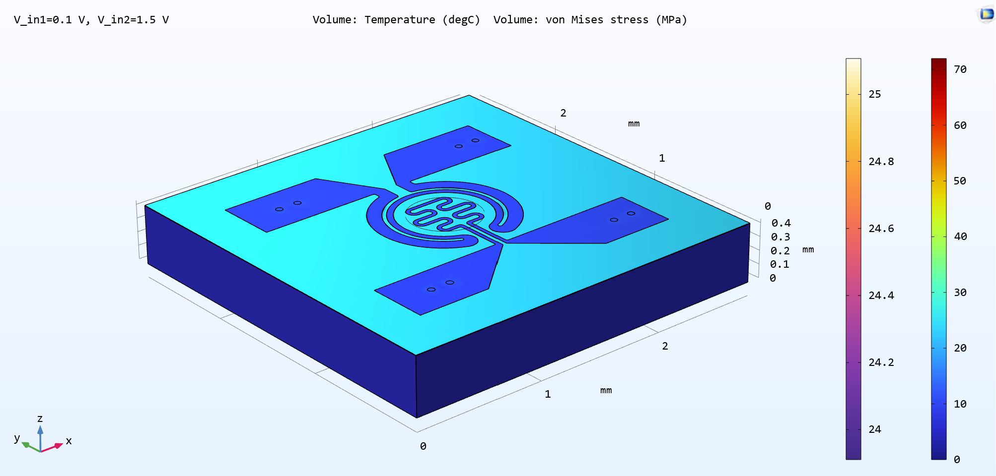

Thank you very much for your kind reply sir, my membrane is a 3D model. Actually we check the intial stress 50 MPa at room temperature with some experimental equipment. I subsititute initial stress 50 MPa in principal diagonal of the matrix in x,y,z directions. After the simulations i checked the initial stress at room temperarure (25 degree). it is showing 70 MPa at room temperature. I am applying the intial stress right? or the results are fine? Thanks again for your reply. Have a good day. regards
>Right-click the Linear Elastic Material node and select the Initial Stress and Strain sub-node. > >If there are multiple materials in the problem you will need to create a new Linear Elastic Material node for the material that has the initial stress. Thank you very much for your kind reply sir, my membrane is a 3D model. Actually we check the intial stress 50 MPa at room temperature with some experimental equipment. I subsititute initial stress 50 MPa in principal diagonal of the matrix in x,y,z directions. After the simulations i checked the initial stress at room temperarure (25 degree). it is showing 70 MPa at room temperature. I am applying the intial stress right? or the results are fine? Thanks again for your reply. Have a good day. regards
