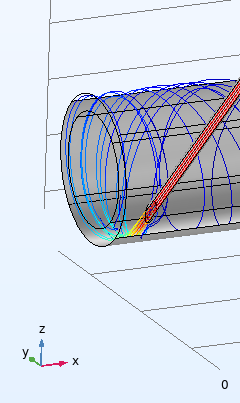

Filtering (e.g., specifying
) works fine for me. Not sure what you did, exactly. Alternatively, if you create your geometry such that the volume in which you want to plot the streamlines is a single domain, you could then use the "selection" feature to plot streamlines only in that domain. If that doesn't help, then I suggest you post your .mph file to the forum so we can all see what you did and then, maybe, diagnose the problem.
p.s. Is the problem caused by a specification of where your streamlines start? Look at (and experiment with) your settings under "Streamline positioning."
Filtering (e.g., specifying y>0) works fine for me. Not sure what you did, exactly. Alternatively, if you create your geometry such that the volume in which you want to plot the streamlines is a single domain, you could then use the "selection" feature to plot streamlines only in that domain. If that doesn't help, then I suggest you post your .mph file to the forum so we can all see what you did and then, maybe, diagnose the problem.
p.s. Is the problem caused by a specification of where your streamlines *start*? Look at (and experiment with) your settings under "Streamline positioning."
