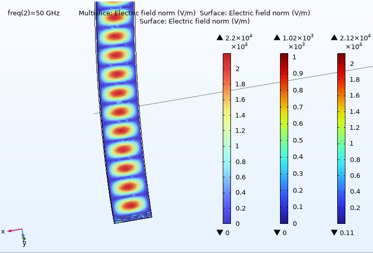

I am simulating mode conversion ( TE10 to TE20) on a hollow curved waveguide of rectangular section. On the Port section I inserted Phase=0 for both ports (input and output). I don't understand why on Port 2 (the output Port) the field is always (almost) vanishing even if I change wavelength, i.e. exp(ikz_port2)=0 (where z is the direction of the waveguide axis). Intuitively I would expect that, based on the relation bewteen wavelength and length of the guide, on Port 2 the solution would change the value of the exponential part (i.e. the part propotional to exp(ikz)). Why this behaviour?

In your waveguide, the cutoff frequency for the TE20 mode is 52.7804 GHz. You were running your model at 50 GHz. This is below the cutoff frequency, so TE20 will not propagate. Either make your waveguide wider or run your model at a higher frequency, if you want to allow the possibility of a TE20 mode to appear.
p.s. On a separate matter, I notice you are plotting sqrt((emw.Ez)^2+(emw.Ex)^2+(emw.Ez)^2). That is not the norm of the field, since E is complex. Instead, I would encourage you to plot emw.normE . If you want to "see" the wave in the guide, then (in your case) plot emw.Ez
