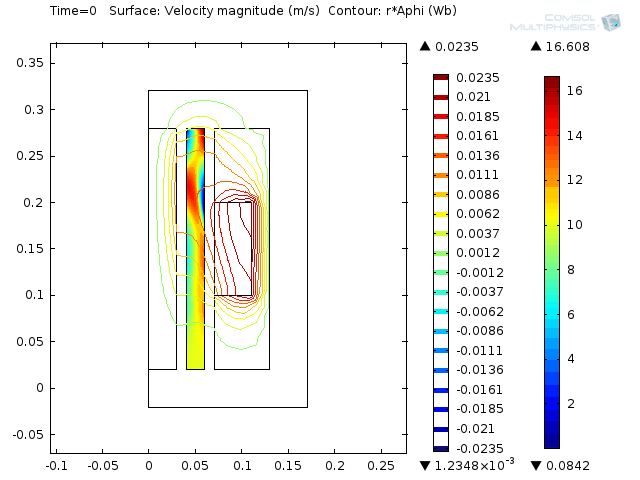

Thank you very much for your help on coupling EM with HD transiently.
In my case I was really interested not to solve flow quasi-stationary but in time domain. At the moment looks like COMSOL handels it quite well - calculation is rather quick for the test model and physics are OK! I attached test model .gif.
Thanks again, Eric!
