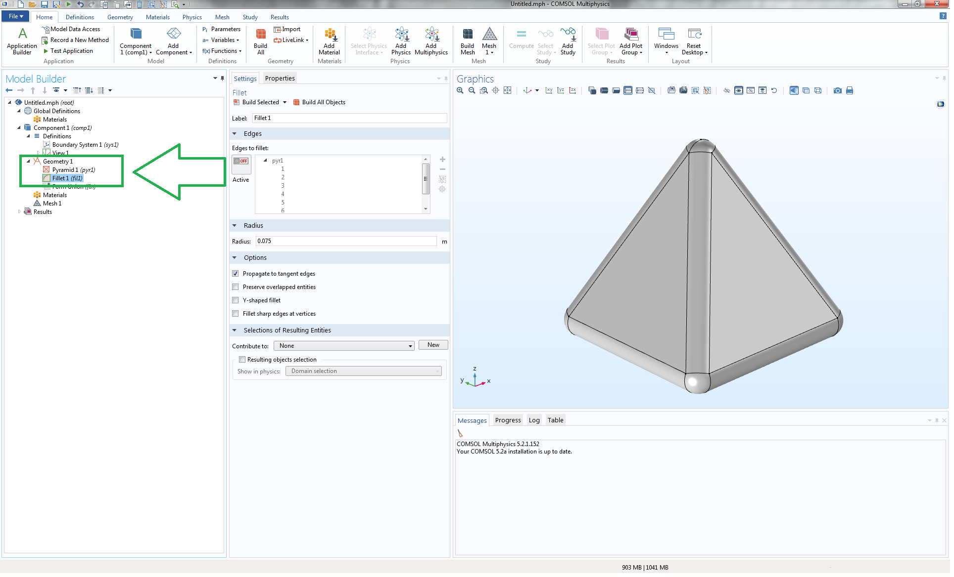

Jeff Hiller COMSOL Employee
Posted: 9 years ago 2016/07/08 9:55 GMT-4
Update: 3D filleting is available in the Design Module since version 5.0: www.comsol.com/design-module . I am attaching a screenshot showing how easy it is now.
Update: 3D filleting is available in the Design Module since version 5.0: https://www.comsol.com/design-module . I am attaching a screenshot showing how easy it is now. Best, Jeff
