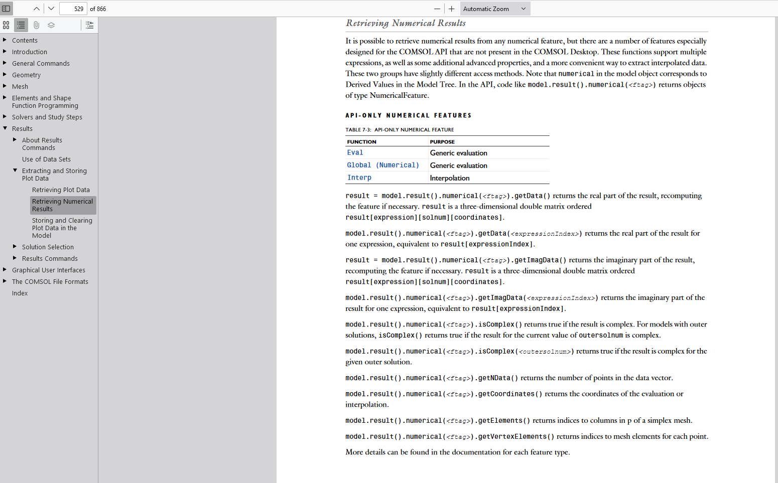

You can use the Interp numerical evaluation feature, see page 529 in your first link to the documentation. I think that this is what the mphinterp MATLAB function does.
Example: To evaluate the expression "my_expr" at x=0.5 in domain 1 in a 1D model, do as follows:
  • NumericalFeature ev = m.result().numerical().create("interp","Interp");
  • ev.selection().geom(1);
  • ev.selection().set(1);
  • ev.set("edim", 1);
  • ev.set("expr"," "my_expr");
  • ev.set("coord", new double[]{0.5});
  • double[][][] data = ev.getData();
