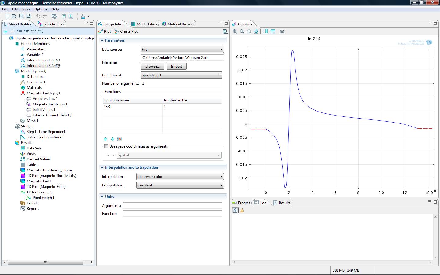

I've interpolated a gaussian current input from several points along time from 0 to 12E-8 (attached file).I'm exciting the loop using magnetic field (mf)'s external current density node along phi (cylindrical system) with "1[A]*int1(t[1/s]))/0.00000019635[m^2]". Note that I've declared "t" as a variable in seconds.

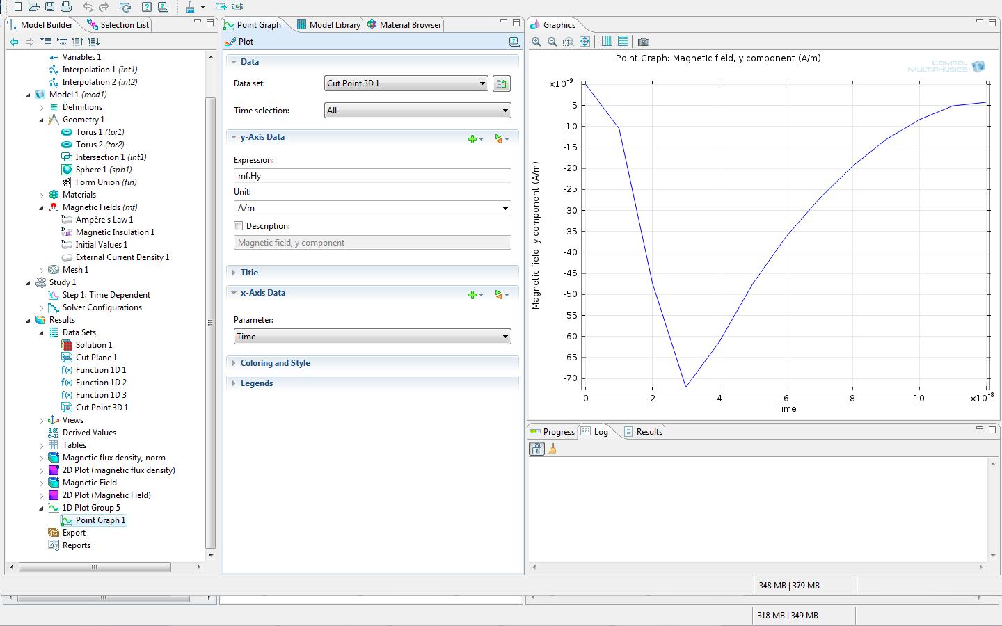

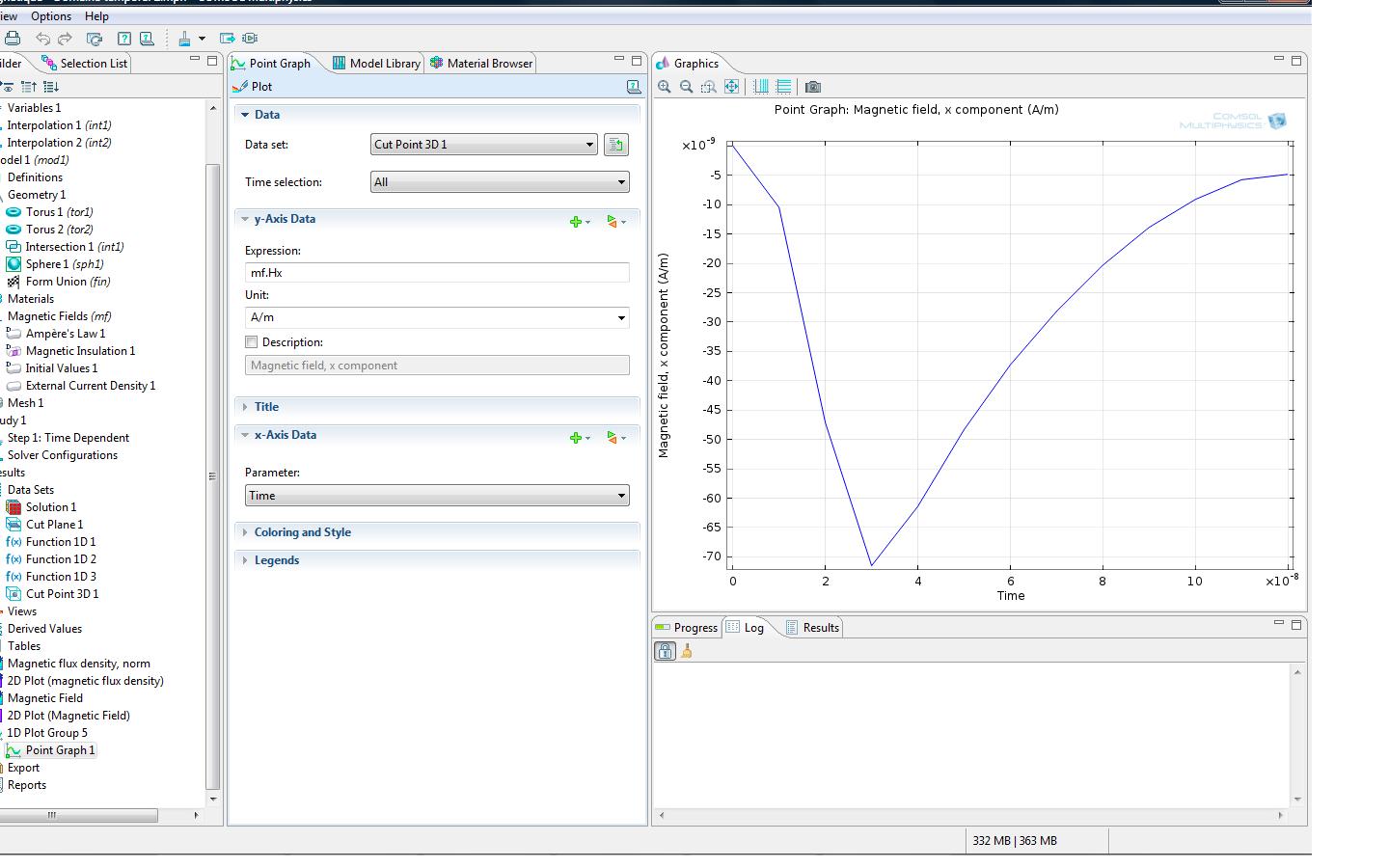

After running the time dependent simulation in "range(0,1.0e-8,1.2e-7)", I wanted to plot the magnetic field of a cut point located at 50mm (x,y and z) along time using the 1D point graph which, basically, must result in a gaussian curve too.

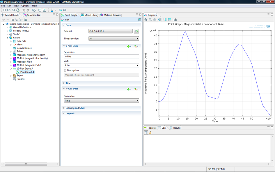

The problem is that I get a very different plot (not gaussian at all) with weird magnetic field values. Another problem is that the curve of the magnetic field with z component (attached) is different from the magnetic field, y component (attached) and also the x component, which I think should have been more or less the same according to my researches.

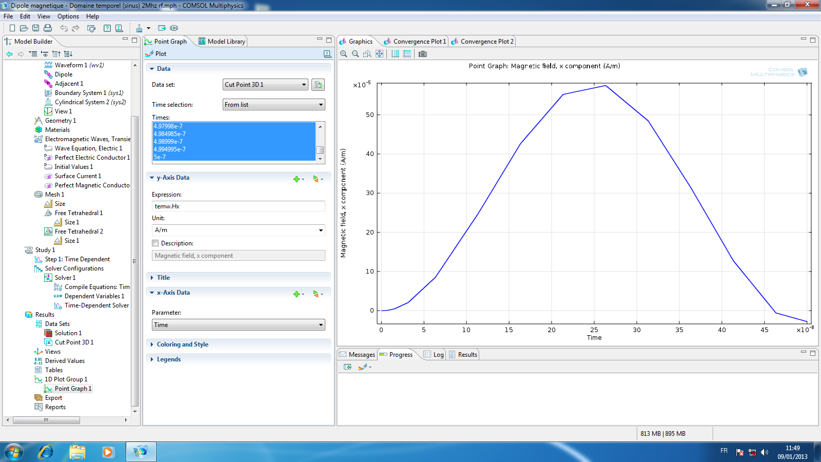

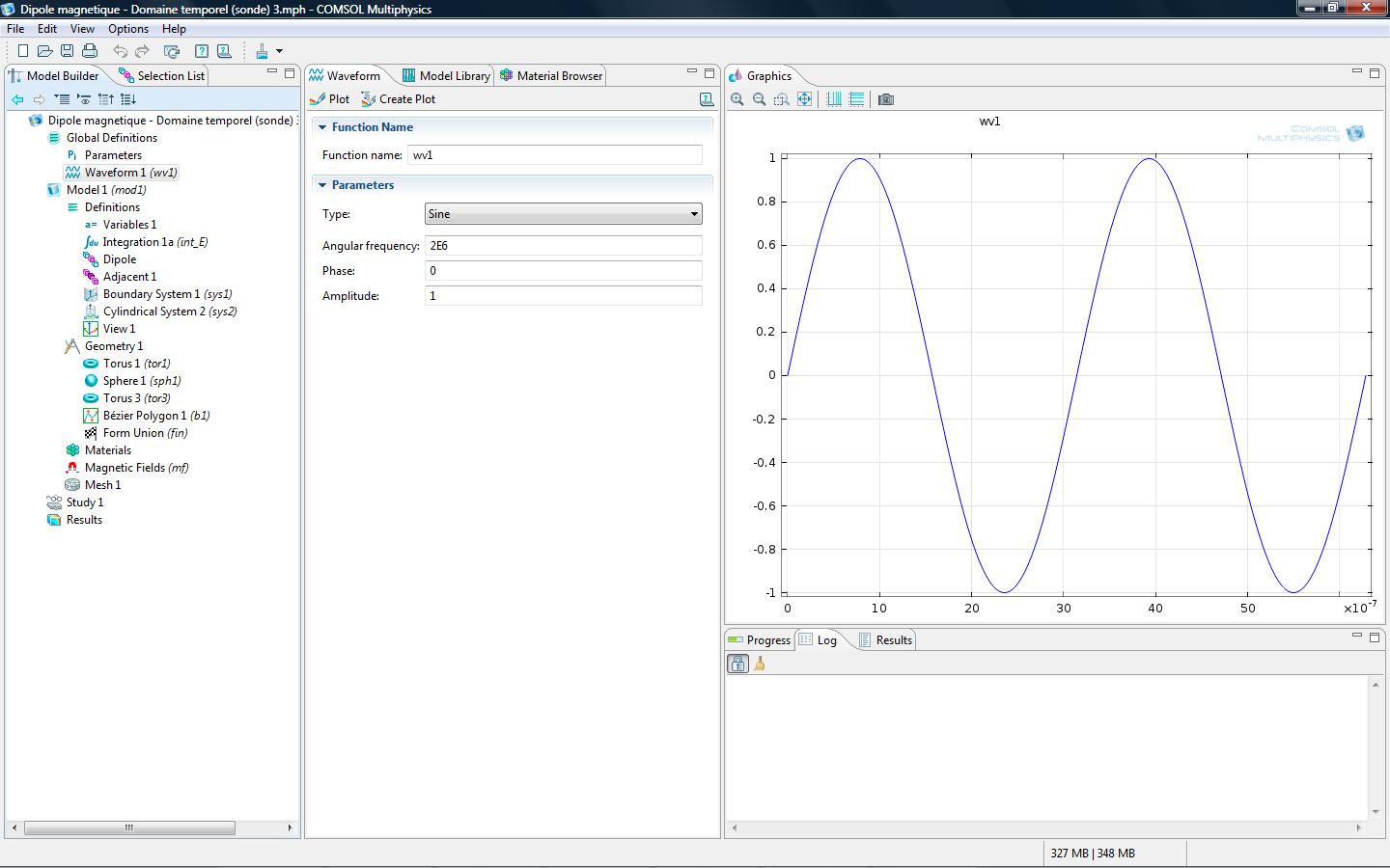

I used a Waveform excitation instead of the interpolation. I declared a sinusoidal current of 2MHz frequency and I excited the coil using "(1[A]*wv1(t[1/s]))/0.000019635[m^2]". Attached file.
I run the time dependent simulation in the range "0, 10-7, 50 10-7". Still, the simulation output of the magnetic field doesn't match the output, even if it's closer this time, since I don't find a sinusoidal plot. Attached also.
What's causing the results to be this inacurrate, please ? Any indication could help me.
