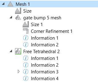

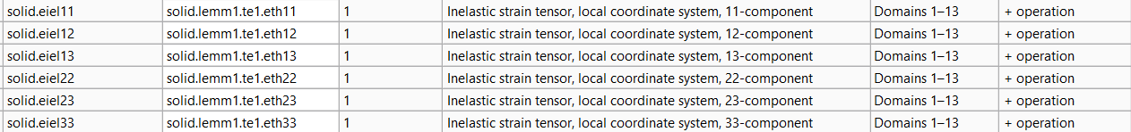

hello Duanhui, please check the mesh quality and initial values before computing.As in the uploaded mph file the mesh quality is not good enough.In the uploaded images you can see information 1, information 2 ........ please check those and for your reference i have attached the image where it says "Failed to find consistent initial values". I hope it helps.

Hi Laksmi,
Thank you very much for your help. I tried a few different things and debugging and now I can narrow down the bug lies at the Creep 1 under the Linear Elastic Material 1. So it feels like that this is a setting issue, as you pointed out.
What I don't get is that I am following the Comsol example to set up the creep and the materials property, but still get this kind of error. :P I will try to further debug and get a narrower scope of the issue. Probabaly I will have a new post more focusing on the Creep settings after that.
BTW, may I know how you get the ref.png in the comsol software? This summary of the input error is very cool and helpful.
