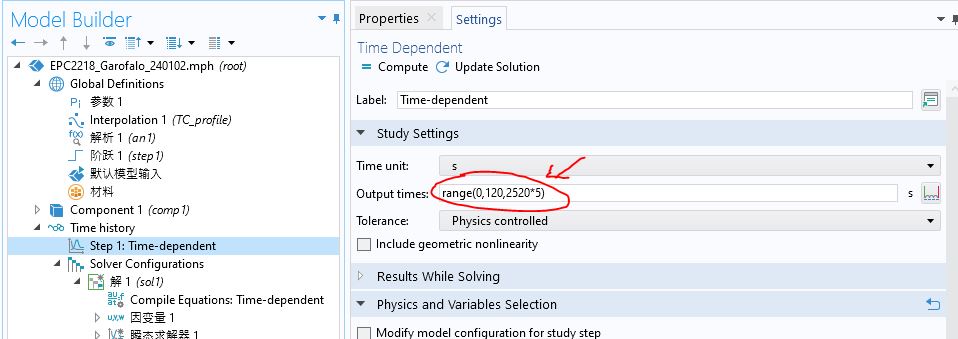

Hi Guys,
What I intended to do is 1: First run a short time dependent study to make sure everything works OK in the time dependent study setting. This is already done. And Comsol shall already have a good solution for the whole setup. (This one step took 3h to finish.) 2: Increase the time steps setting in the solver and use the "Update Solution". Now I expect the time dependent study will only need to calculate the value for the increased time steps instead of solving for everything.

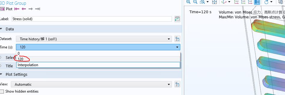

But when I tried this, it seems the "Update solution" did nothing. At least in the resuts, the time steps results are still the same as the before.
I am wondering if there is some setting I did wrong in this case, or I misunderstood the functionality of "Update Solution". Could you help me if you encoutered something like this before?

Thank you Magnus. You cleared my confusion. May I ask if I want to take advantages on the solution from step 1 to get results of the increased time steps, what will be the right approach? My goal is to save the time for comsol to get an initial solution, which seems to take the most of the time. Is there a blog or reference I can learn from? Thank you!
