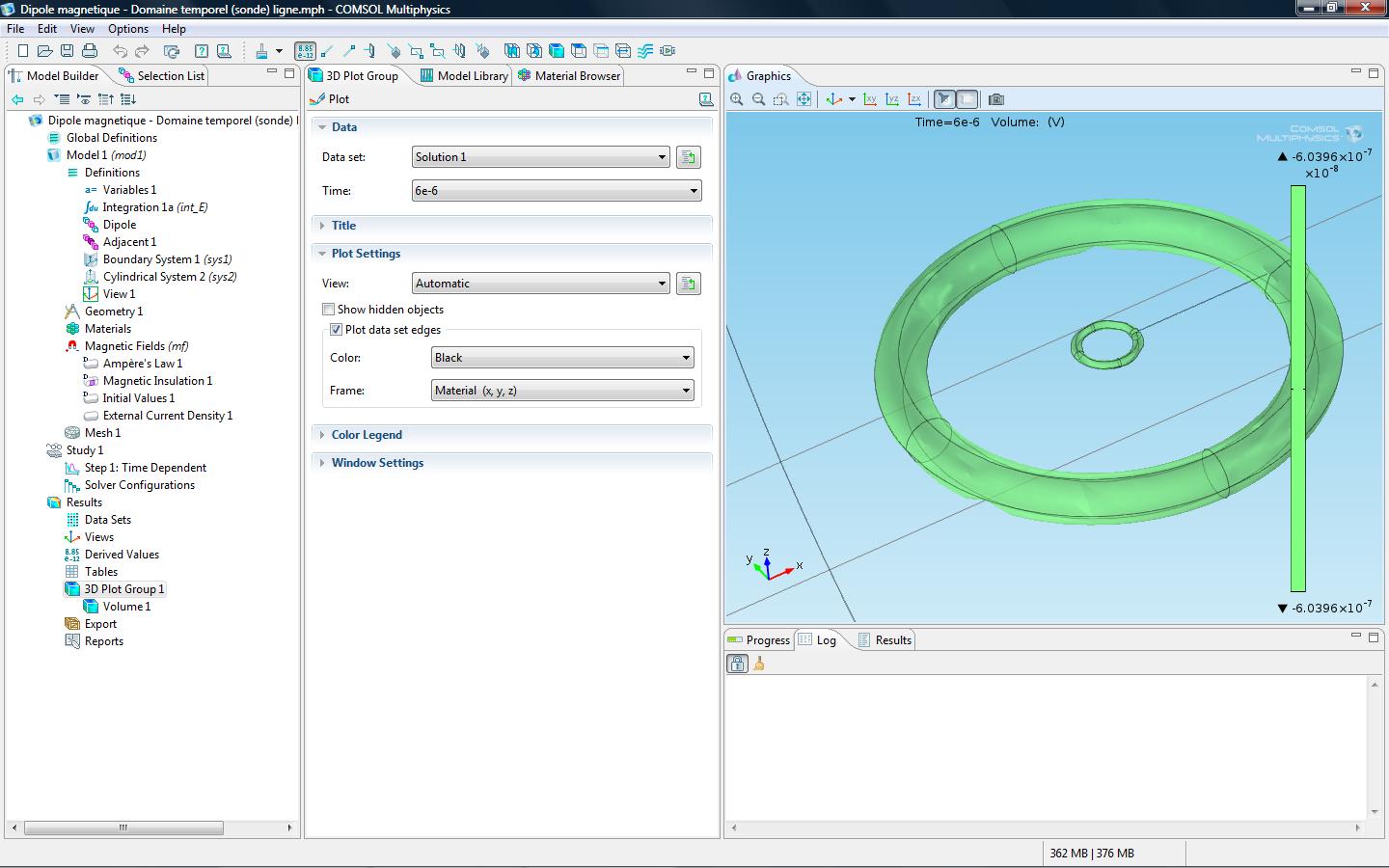

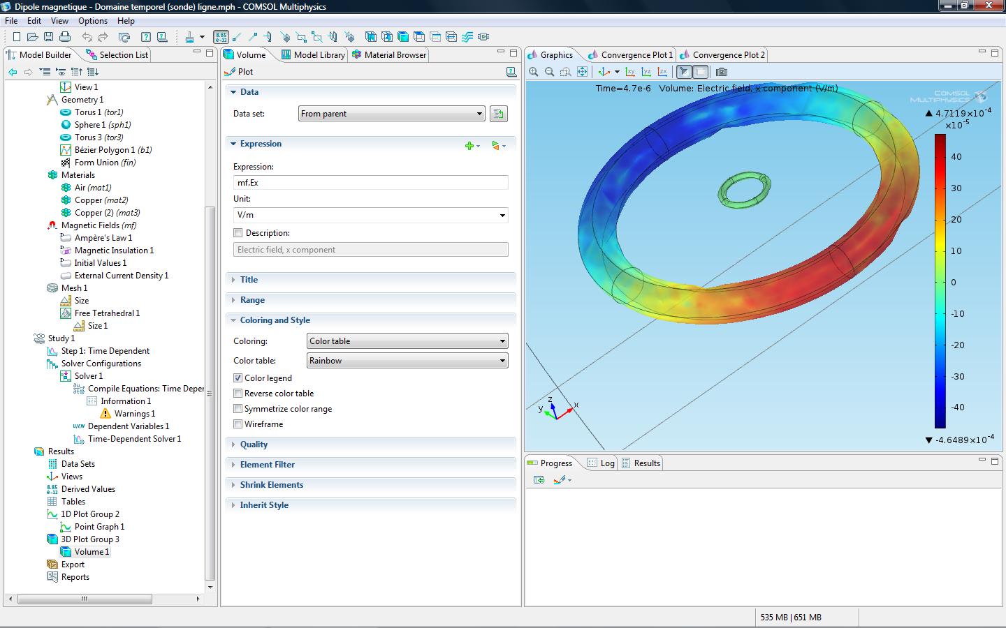

The problem is that when I run the simulation and I pot the Electric field, the inner little torus doesn't seem affected by the outer torus' fields since the electric field is null there. Like it's shown in the attached file.
When I simulate the V voltage it's even a worst problem since no torus seem to have a voltage. Also attached.
What's wrong in my approach please ?
Thanks very much for you help
