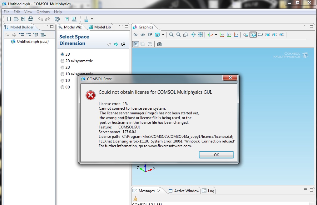

Also I am facing the same problem with win7.
Please Help.
ishantiitk@gmail.com
Also I am facing the same problem with win7. Please Help. -- ishantiitk@gmail.com

Please notice the following two options:
The detailed error message contains the string
FLEXnet Licensing error:-15,10.
means the license manager is not running on the license server. Note that when COMSOL is installed on the server machine you have to run license manager on the server machine as well. Please have a look at the "Installation and Operations Guide" available at " www.comsol.com/iog " on how to install and start the license manager. Here is also a video tutorial on how to run license manager:
www.comsol.com/products/tutorials/FNL_License_Manager_Install/
The detailed error message contains the strings
FLEXnet Licensing error:-15,570.
indicates that there is a firewall on the license server that is preventing the connection from the COMSOL client computer to the license manager.
Please notice the following two options: The detailed error message contains the string FLEXnet Licensing error:-15,10. means the license manager is not running on the license server. Note that when COMSOL is installed on the server machine you have to run license manager on the server machine as well. Please have a look at the "Installation and Operations Guide" available at " www.comsol.com/iog " on how to install and start the license manager. Here is also a video tutorial on how to run license manager: http://www.comsol.com/products/tutorials/FNL_License_Manager_Install/ The detailed error message contains the strings FLEXnet Licensing error:-15,570. indicates that there is a firewall on the license server that is preventing the connection from the COMSOL client computer to the license manager.

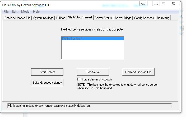

Posted: 1 decade ago 2015/09/10 0:47 GMT-4
Hi There
After I follow the steps shown in the clip, I still have the same error. Also, when I click start server, the massage is appear as " VD is staring, please check vendor daemon's status in debug log' instead of "successful". How could I fix the problem ?
Cheers
Ramsay
Hi There After I follow the steps shown in the clip, I still have the same error. Also, when I click start server, the massage is appear as " VD is staring, please check vendor daemon's status in debug log' instead of "successful". How could I fix the problem ? Cheers Ramsay
