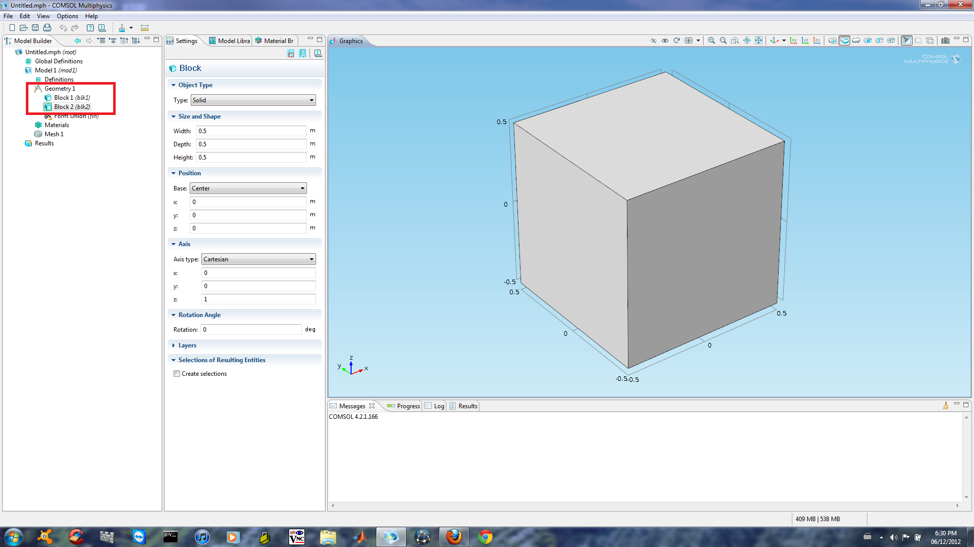

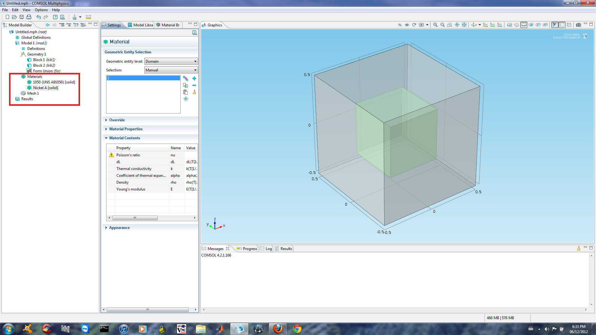

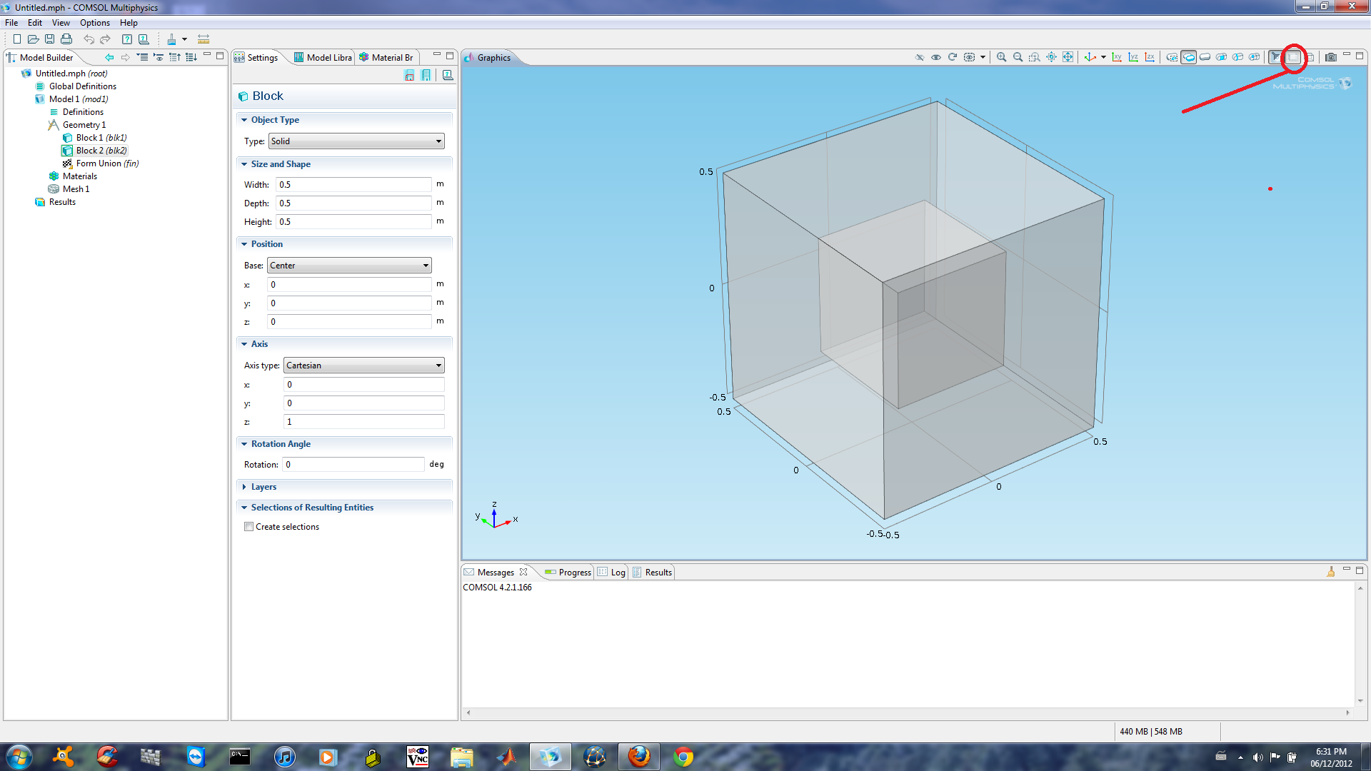

attached find the image files of the model. First create two blocks of different size (_1), then go to transparent option (_2), go to material and select the materials that you want and define them under domains selecting any domain (block) you want (_3).
cheers
Mayur
Hi, attached find the image files of the model. First create two blocks of different size (_1), then go to transparent option (_2), go to material and select the materials that you want and define them under domains selecting any domain (block) you want (_3). cheers Mayur

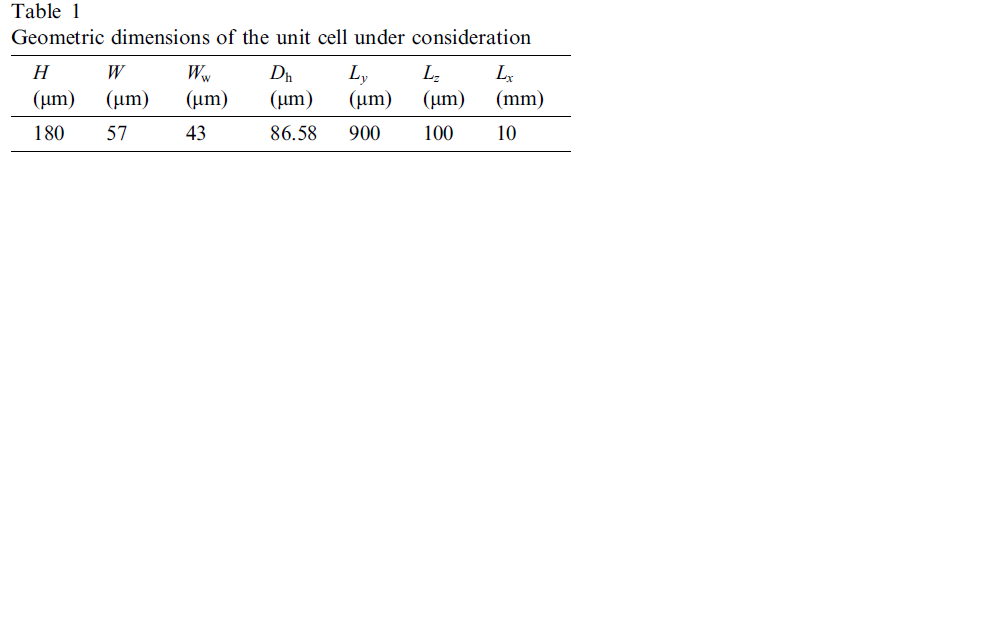

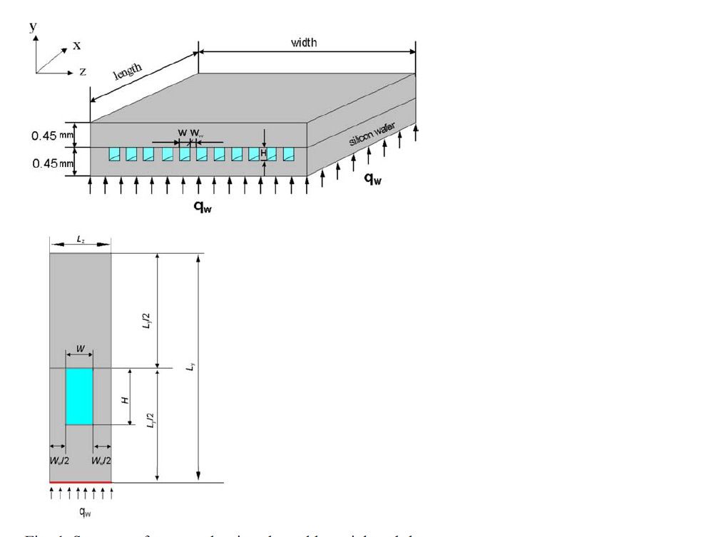

But Still the geometry what i was planning to desing has dimebsion
100X900X10000
Where each heat sink has dimension 57X180X10000
and there is equal length from each node in X-direction.
I am attaching the geometry of what I am trying to design with this. Where actually sink is somwhere inside the channel and not exactly at the base how you defined in the model.

are you trying to replicate the result published in International Journal of Heat and Mass Transfer 47 (2004) 4215–423?
Posted: 1 decade ago 2012/12/08 10:59 JST
Yes, I am trying to use this geometry for my practice.
Posted: 1 decade ago 2012/12/08 11:00 JST
I mean same geometry of International Journal of Heat and Mass Transfer 47 (2004) 4215–423?
Posted: 1 decade ago 2012/12/08 11:12 JST
okay, after looking at this paper, it seems water is flowing through the cyan color channel (Fig 1 and 2 in paper), actually you tried exactly opposite to what is given in the paper.
