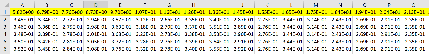

Hi Edgar, many thanks for you suggest!
I have done some test but I didn't understand how I have to define my data. As I have read it's not possible used a grid with more 3 rows, is it correct? I have a file excel defined as in photo in which the yellow cells are the x coordinates and the rows from 2 to 6 are the number of timestep i.e. 1s, 2s, 3s...
How can I define a f(x,t) function in Comsol with my data?
Thank you in advance for your help! Marianna

Posted: 2 years ago 2024/02/01 12:47 GMT-5
Hi Marianna,
in the lines below the %Grid line you specify the nodes of your function, i.e the x and y values, or x and t in your case. So the first line would contain all the x values in the yellow line. The second line contains the t values, e.g. 1, 2, 3, etc. You don't need a third line because you only have two arguments in the function.
Below the %Data line you specify all the data values f(x, t) for the nodes in your function. Those are all the values in the white lines in your Excel sheet. They do not need to be structured in lines. This will be done according to the data under %Grid.

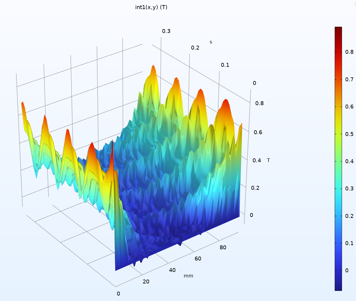

Marianna Di Pietrantonio
Posted: 2 years ago 2024/02/02 10:43 GMT-5
Hi everyone, first of all thank you for helping me!
I finally fixed this problem and got the graph shown in the photos which is exactly what I expected.
Now I have another problem related to simulation convergence. I imposed the function int1(x,t) in the magnetic field-point constraint section as mf. By-(int1(x,t)) and I've tried changing some solver settings but it doesn't work.
Do you have any suggestions?
