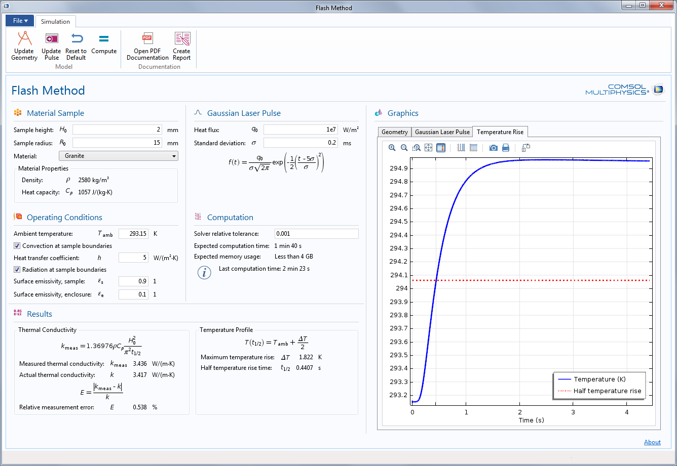

Good afternoon I have simulated the flash method and I already have the 1D plot group (temperature rise on the lower surface, a photo is attached) but I cannot find a way to make COMSOL to calculate the half temperature rise time. I have the Idea to skech a line (on the average of min and max temperature during the time of study as the red dashed line in the attached photo) in the graph to read the intersection but so for I have not found a way to do that. Thank you a lot great guys!
