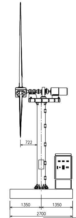

I am currently developing a digital twin for a wind turbine using COMSOL Multiphysics. Specifically, I aim to model the effects of torque and forces generated by the rotation of the blades on the tower to predict its displacement. For this project, I plan to model the blades separately, simulate their rotation, and then apply the resulting forces to the tower model.
(As a note, the wind turbine is set up as a testbed for structural safety tests and is located indoors, thus it does not rotate due to wind. I can control the RPM, allowing me to adjust the baseline RPM for experiments. When conducting FSI analysis, it seems I just need to add AIR.)
So far, I have:
Modeled the tower and blades in 3D and conducted a natural frequency analysis. I am uncertain about the most effective way to transfer forces from the blades to the tower. I need guidance on whether to consider Fluid-Structure Interaction (FSI) and how to implement it. In fact, my biggest concern is figuring out how to simplify the calculation of loads when the blades rotate fluidly. I am looking for the best way to integrate rotational dynamics and structural response.

I will also attach a part of the wind turbine's blueprint I am aiming to model, just in case. Thank you again.
