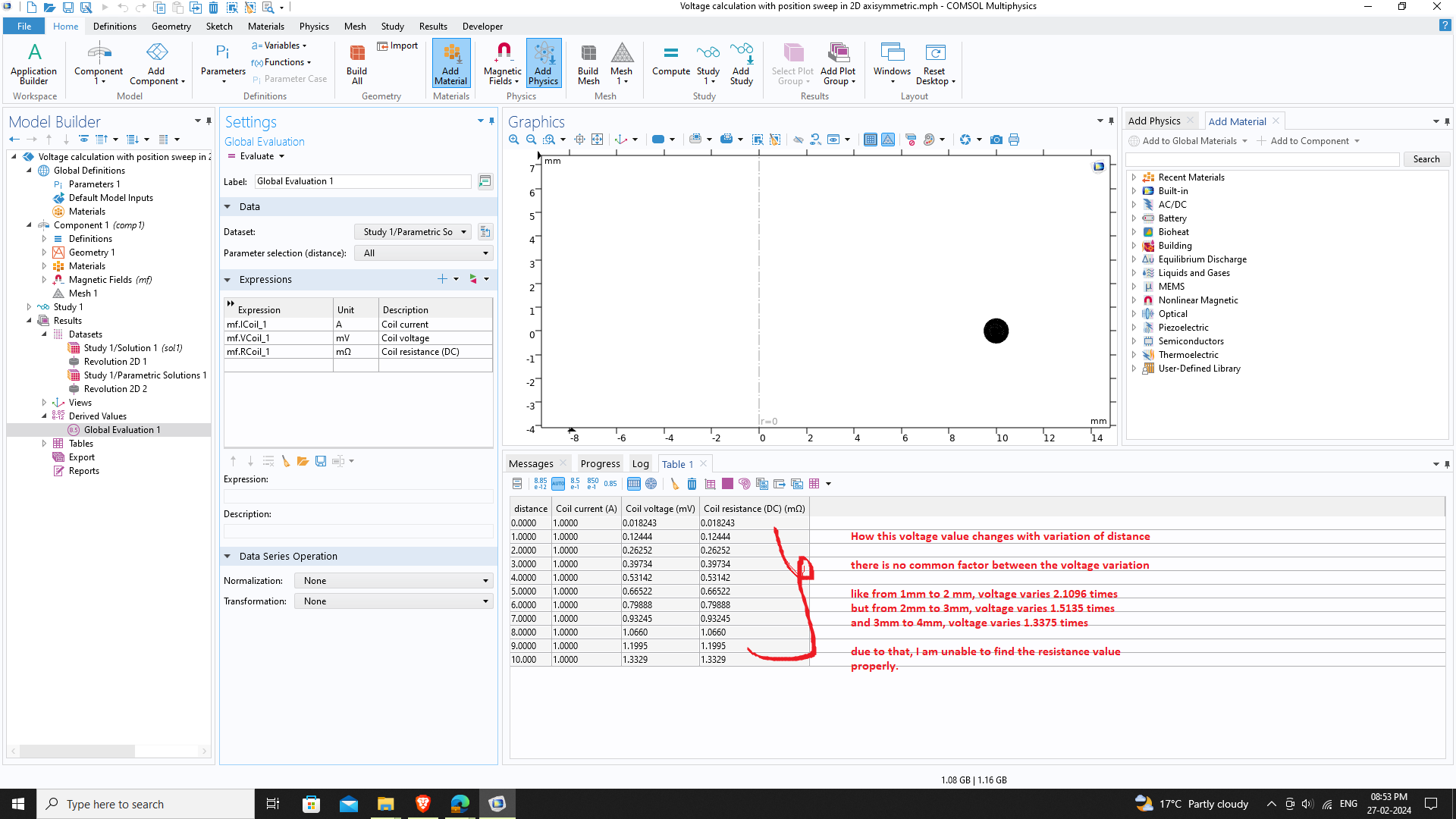

Dear all, I am designing a simple 2D axi-symmetric model of single strand coil by providing current excitation in magnetic field (mf) domain. Here, I am measuring the voltage of the coil and then resistance value. When I sweep the Position of the coil from zero-axis, it will generate different revolved geometry. however, I am unable to find how these voltages vary with the position. it seems there is no relation of these voltage changes.
furthermore, computing its DC resistance value using R = pL/A formula is also very complicated in the 2D-axisymmetric model.
please help me to find the how this variation gives different results???

Isn't it just that the resistance scales linearly with circumference, and the circumference scales linearly with radius? You get twice the voltage at 4 mm than at 2 mm, and four times when comparing 8 mm to 2 mm. And the 0 mm gives you a weird geometry, when seen axisymmetrical, so skip that.
