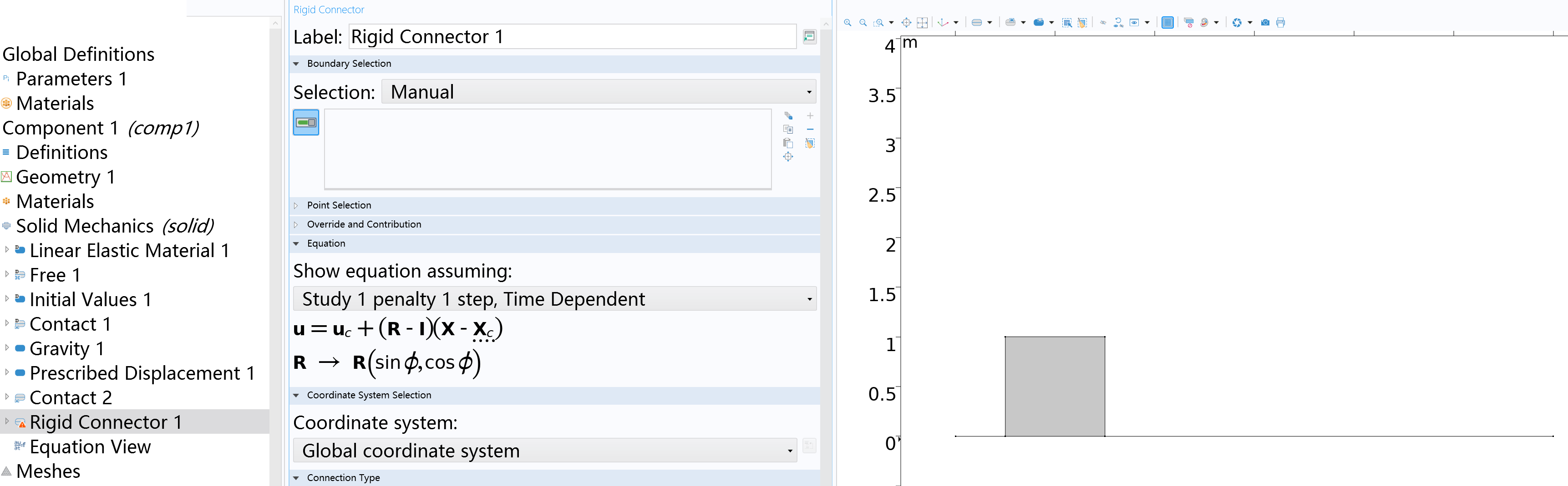

Thank you very much Dr Sönnerlind. In the attached figure the long straight line representing the ground is what I refer to as the edge or line and what I wish to be rigid. Then I tried to add your rigid connector but I am not allowed to choose that straight line as the rigid connector, yet instead I can only choose the bottom line of the square. If the bottom line of the square isn't rigid, may I not use a rigid connector any more?

As I understand it, you want to simulate contact against a plane that is not really a part of your structural mechanics problem.
A quick (but not elegant) solution is to add a thin strip of material also below the long line, and proceed as for any contact problem.
But you can also just draw the line and mesh it (1 element is enough if it is straight), without having any physics attached. You can then use that line as source side in a contact pair. Note however that when the line does not have an adjacent domain, it does not have a natural 'outwards normal'. So for the contact search to work, the line must be drawn with the correct orientation (you want to have the solid on the left side of the line).

Thank you very much Dr Sönnerlind. By drawing a line, you don't mean using a rigid connector any more do you? Then I think a rigid connector can be used only when the bottom line of the square is rigid.

That's correct. If there is no physics at all attached to the line, it will not move.
