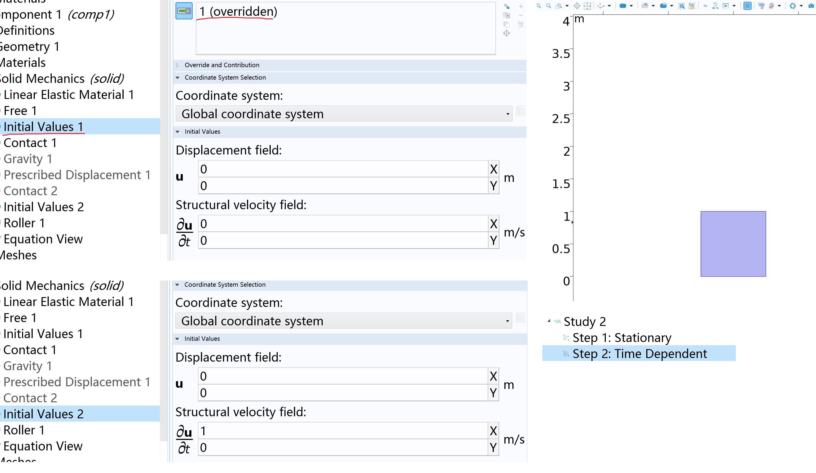

Posted: 2 years ago 2024/04/02 22:29 GMT-4
Thank you Dr Sönnerlind. I strictly follow your advice (In step 1, disable the second Initial Condition node under Modify model configuration for study step) as in the attached figure. But the block never moves. It seems that the second initial condition isn't applied at all by the software.
Posted: 2 years ago 2024/04/04 21:26 GMT-4
Will the interface of "values of dependent variables" and " Initial values of variables solved for" be relevant to this question?
Posted: 2 years ago 2024/04/08 5:29 GMT-4
That is correct. You need to take initial values from User Controlled -> Initial Expression in the second study. The default is to use results from the previous study as initial conditions.
Henrik Sönnerlind
COMSOL
That is correct. You need to take initial values from *User Controlled* -> *Initial Expression* in the second study. The default is to use results from the previous study as initial conditions.
Posted: 2 years ago 2024/04/09 10:11 GMT-4
Then in such a case, the solution of the current step has nothing to do with the solution of the preceding step under the same study? This is equivalent to putting these steps in separate studies?
>That is correct. You need to take initial values from *User Controlled* -> *Initial Expression* in the second study. The default is to use results from the previous study as initial conditions. Then in such a case, the solution of the current step has nothing to do with the solution of the preceding step under the same study? This is equivalent to putting these steps in separate studies?
Posted: 2 years ago 2024/04/10 3:50 GMT-4
In most cases, it will be the same, yes. There are some subtle exceptions, for example if you don't solve for the same degrees of freedom in both study steps. But by making the appropriate settings, you can obtain the same results using either two studies or two study steps within one study. it is more a matter of convenience. Study steps within one study are mainly intended for cases where there is a chain of solutions that depend on each other.
There are some other differences, not directly related to the solution. There will, for example, be a difference in how default plots are generated when you switch between two study steps and two studies.
Henrik Sönnerlind
COMSOL
In most cases, it will be the same, yes. There are some subtle exceptions, for example if you don't solve for the same degrees of freedom in both study steps. But by making the appropriate settings, you can obtain the same results using either two studies or two study steps within one study. it is more a matter of convenience. Study steps within one study are mainly intended for cases where there is a chain of solutions that depend on each other. There are some other differences, not directly related to the solution. There will, for example, be a difference in how default plots are generated when you switch between two study steps and two studies.
