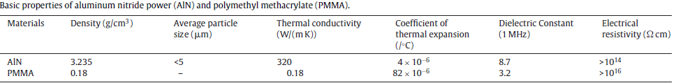

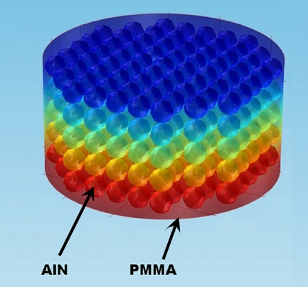

i need to calculate thermal conductivity for various volume fraction of ALN with PMMA. In that paper they mentioned about When the sample is given a heat power,the direction of heat transfer is lower to upper of the cylinder (PMMA).
PMMA they used as cylindrical shape and ALN they specified as sphere. Could you help me how to get the thermal conductivity from input file.(i had attached my input file with this message).

If ALN particle size(sphere) should be less then 5um then what are the procedure i need to follow ?

OK but then you have 2 approaches, your method with one lumped sphere might be sovled by a FEM model as you built it,
but if you say you are mixing two materials in a homogenious way then you could probably use a rule of the type
k_eq = (1-pr_aln) * k_pmma + pr_aln * k_aln (for parallel conductances, and the "1/" for serial conductances)
where pr_aln is therelative material volumic ratio of the ALN , but it all depends on what you want to show
You could apply similar formulas for rho, and Cp
make it a try, and perhaps take a look at the COMSOL approach for two mixed material in i.e. porous matrerial examples

I'm not sure there is anything "wrong" apart that I would not define any boundary layer, just leave the "domains"
Now you have 3 variables: radius of sphere, radius of cylinder and height of cylinder, while the other formulas from the articles, are related to a sphere inside (and same "centre" of) a cube hence only two variables cube length and sphere radius.
To check the formula you need to reproduce exactly the same conditions, it works rather well for a stationary case (cube and sphere) see attached model (4.3a) but then there are two remarks, first for dynamics none of these formulas (and only a correct FEM model) will give you the right values, and what about the BC you use, I have tried both fixed T on bottom, constant average power on top, and fixed T on top and on bottom, with a fixed DT. for the stead state conductance one get the same average value, but looking closer on the heat flux values, or the T variation on the constant flux side one see quite some variations in flux to get the same constant temperature.
Ideally I should set periodic T values at the two/four vertical Boundaries, in addition to isolation/symmetry but with a regular mesh these conditions should be rather equivalent anyhow
My model has a 2D (cylinder in cube), and 3D true sphere in cube model, only the later agrees well with the formula
For your case you need to adapt the cylinder radius to the cylinder height and then adapt the values to your volume fraction
