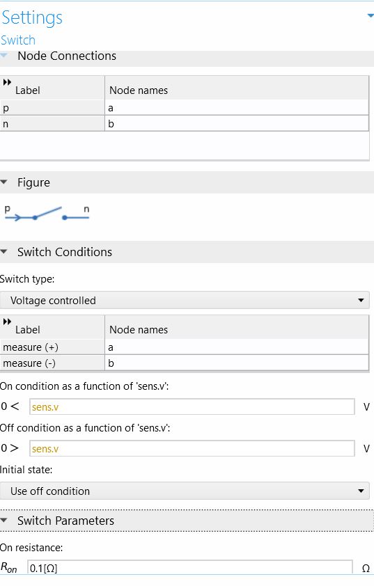

I am currently using the subcircuit definition in the Electrical Circuit (cir) module and I am confused as to how I am supposed to define the on and off conditions for the "switch" component. To define it, COMSOL says to define the condition as a function of 'sens.v' but when I try to state a condition as the following (without any quotations),
"sens.v"
, it states that there is an "unknown variable sens.v". Can anyone show me an example of how to state the function so that sens.v is the measured node where measure(+) is a and measure(-) is b?
Thanks in advance!

The unknown variable indication/message is a glitch in the user interface that we will correct. The model will still solve correctly. The documentation can indeed be improved. The way the switch works is that the on/off Boolean expressions trigger the state of the switch to change when going from false to true (but not the other way around).
The state of the switch (on/off) is changed only when a condition goes from false to true and not when going from true to false. Thus, if the state is off and the on condition goes from false to true, the state will shift from off to on. On the other hand, if the state of the switch is on and the on condition goes from true to false, nothing will happen.
We will amend the documentation accordingly.
The attached example illustrates how to trigger switching by a sine wave. Note that we have tweaked the time-dependent solver to use more densely spaced output times and also changed the time stepping to use the Strict method to make sure that no switch triggering events are missed.
Magnus
