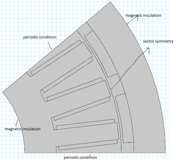

Hi Akmal,
I met the same problem as yours. Have you handled it? I set the boundaries as shown in the attachment.
Look forward to your reply.
Xuezhou
Hi Akmal, I met the same problem as yours. Have you handled it? I set the boundaries as shown in the attachment. Look forward to your reply. Best regards, Xuezhou
Posted: 1 decade ago 2013/05/31 18:04 JST
Xuezhou Wang, periodic BC can be ignored if the slice made respecting symetry. just like brock did.
Brock, dont forget to define air domain between coil dan soft iron.
regards
akmal
