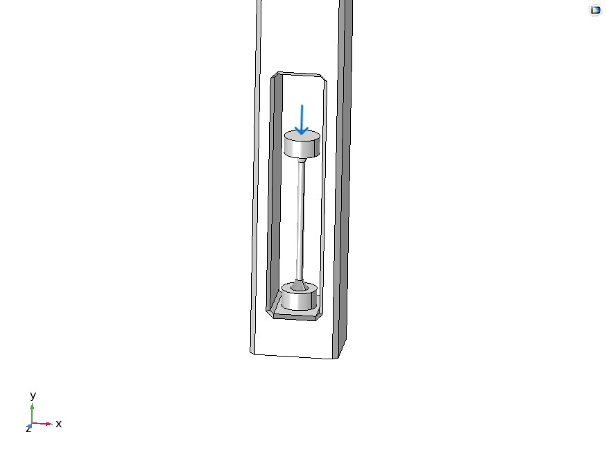

I want to put a point mass at the top face of the lower flexure (see the image below)
I attached another image that show where i want the point mass (see the image with the blue arrow).

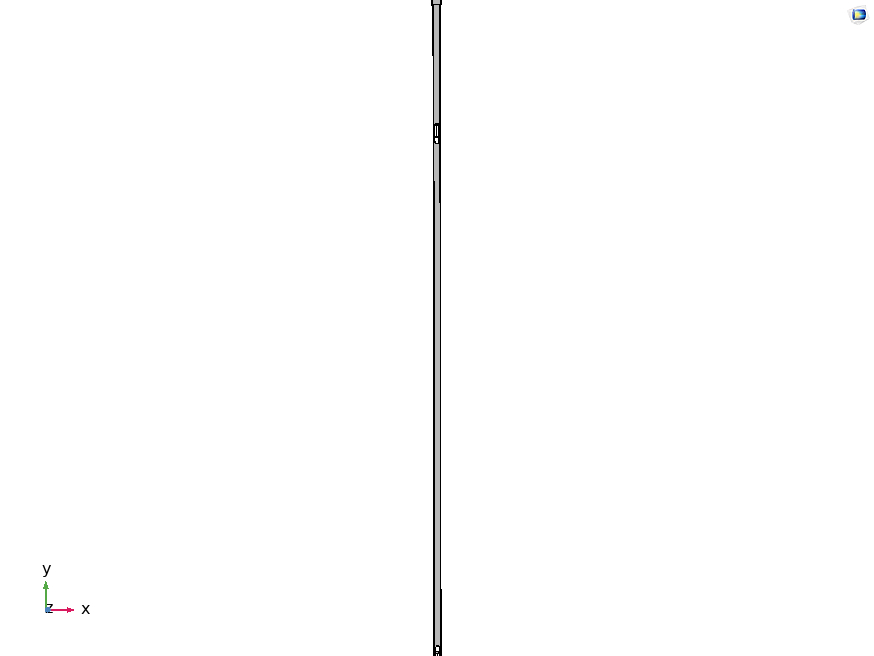

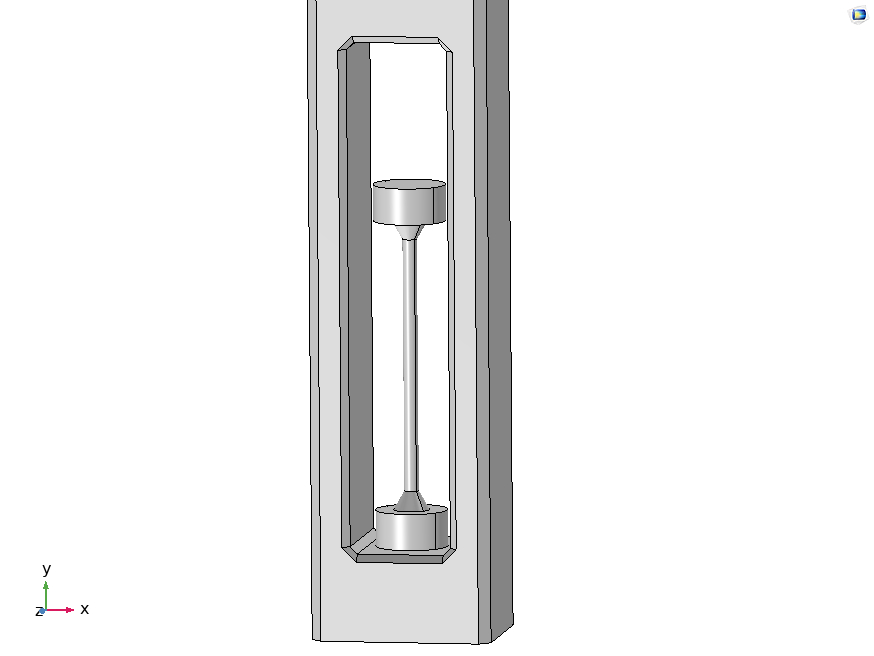

For referance I attach the mph.file for the system that is used for the simulation and a image of what it look like.

There is no point mass feature in the Solid Mechanics interface. The reason is that a point mass causes a type of singularity, similar to a concentrated force. It is better to distribute the mass over some small boundary, using an Added Mass node.
You can also use a Rigid Connector with a Mass and Moment of Inertia subnode. Note that you can select a flexible formulation, if the constraints imposed by the rigid connector are too hard.

got it i will use an added mass boundary thank you very much!
