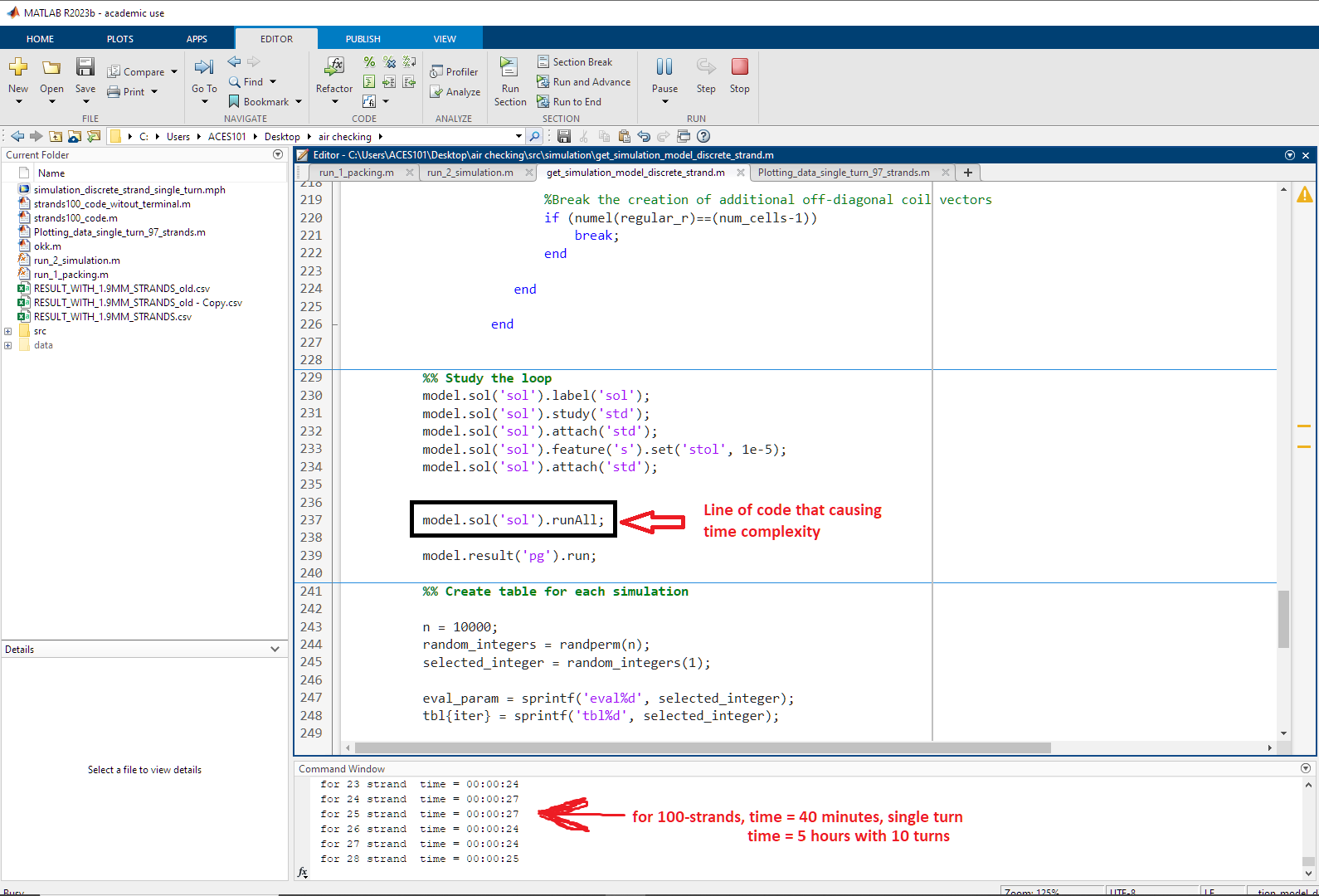

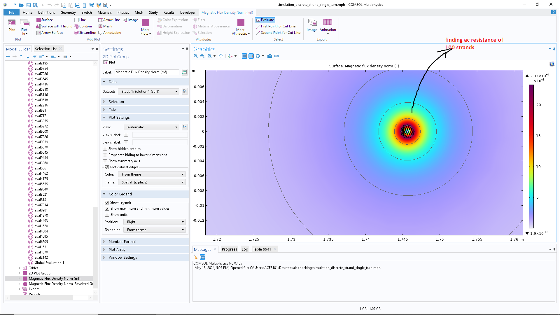

    I am simulating coil strands to know its AC resistance. i am using LiveLink for MATLAB to automate this task. however, for 10 turns coil with 100 strands, the total simulation time goes to 5 hours while for 10 turns with 300 strands, the total simulation time goes 50+ hours.
    by profiler code checking, i found that *** model.sol('sol').runAll;*** is taking 95% of overall simulation time. can you please suggests me to reduce the time duration of simulations.

Be aware that some problems are just too big.
However based on your drawing it looks like you have six-fold symmetry. Use it.
Be aware that some problems are just too big. However based on your drawing it looks like you have six-fold symmetry. Use it.
