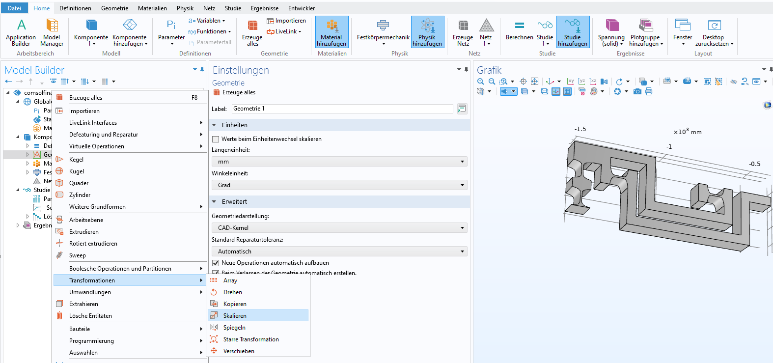

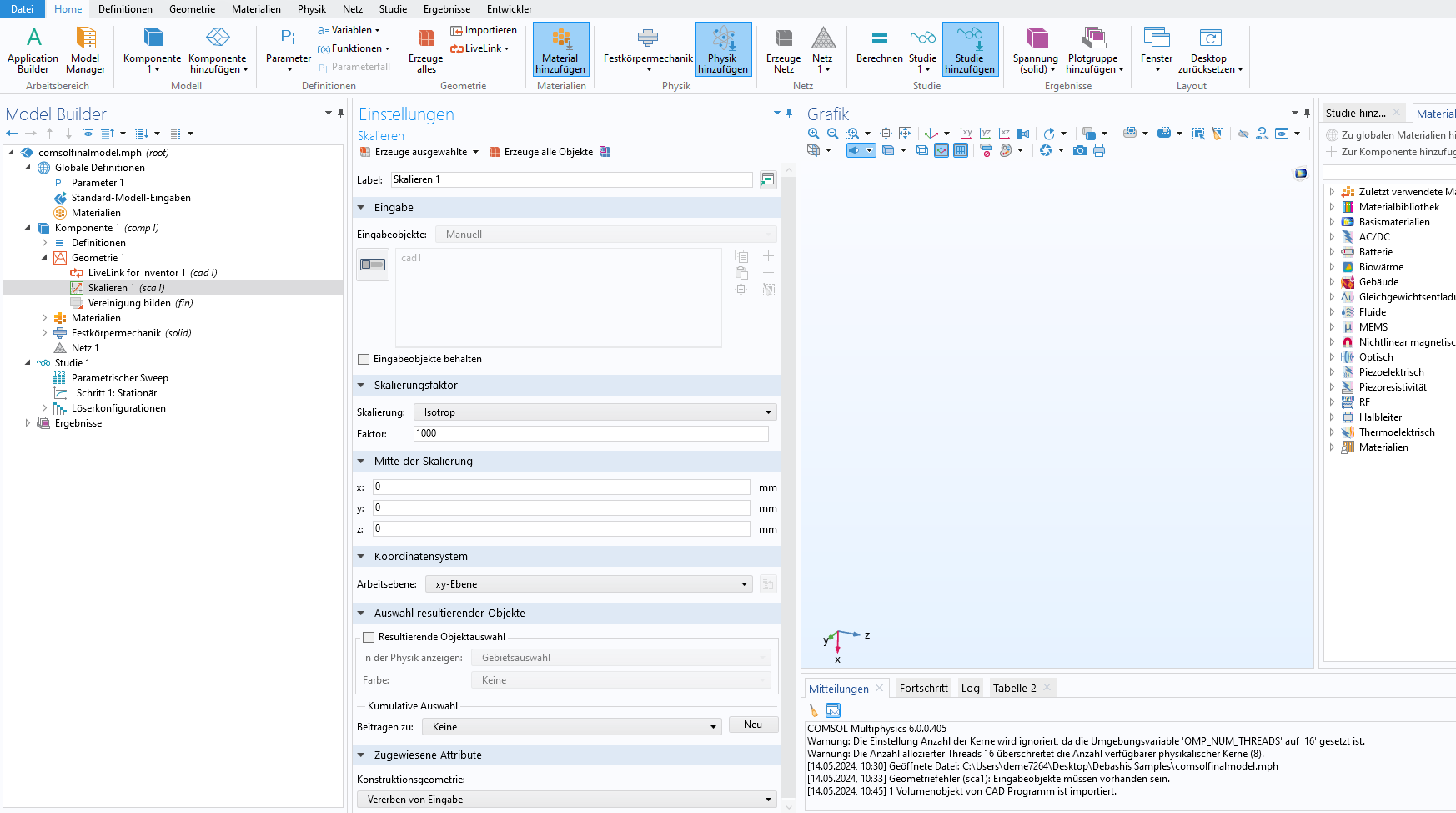

I have a model created and defined dimensions as parameters in millimeter range and I want to scale it down to micrometer dimension. I used the scaling option under geometry and add 1000 as scaling factor with isotropic option selected but after I clicked the build option, it processed the image and didnt show anything in the right hand side and sometimes it throws error saying "the object to be scaled must be selected".
I did select the CAD image as can be seen in the below screenshots image 2,image 3.
Am i doing some mistake in the whole scaling down process? could you please advise .I use COMSOL 2024 version. Is there any other way to scale down the parameters in comsol from millimeter to micrometer?
Image 2.png below is the inital image to be scaled but Image 3.png is the scaled image that vanishes when i click build all.
Kind reg Amit

1/ If you want to make the object a thousand times smaller, then use a scaling factor of .001
2/ Use the Zoom Extents button to make the geometry fill the Graphics window
3/ There is no version of COMSOL called "2024 version". The version you are using, per your screenshot, is 6.0.0.405, a.k.a. 6.0 update 2, which dates back to 2022. The latest version is 6.2 update 3; it was released today.

thankyou very much , it worked
