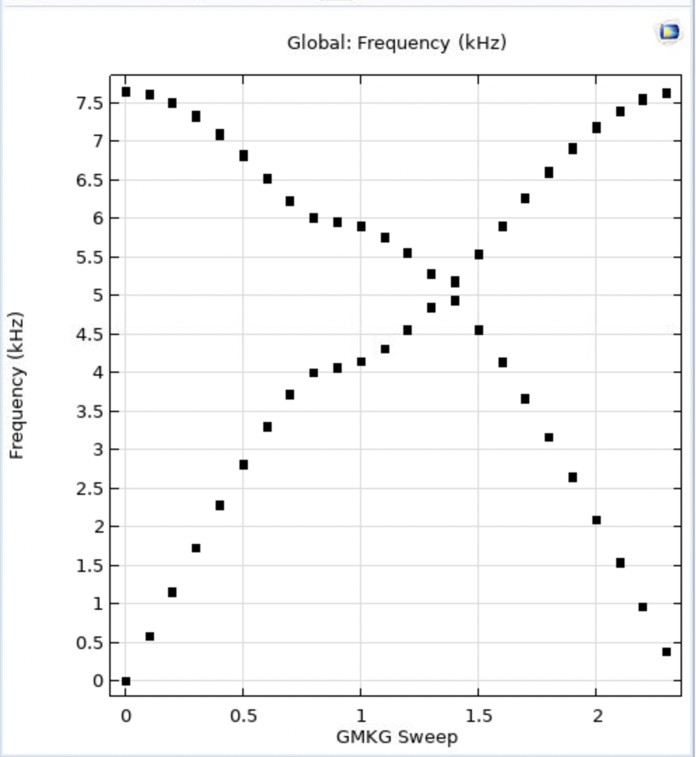

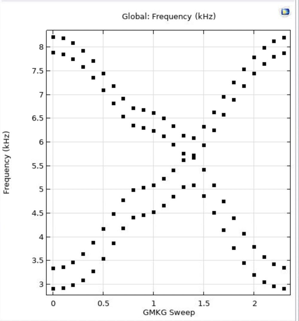

My issue currently is that when I have the wood interlayer membrane (labeled domain 3) under Solid Mechanics, the coupling between the two layers doesn't seem to register. I've attached two screenshots, showing what I expect (and get when I select the interlayer domain under Pressure Acoustics instead) vs. what I get (interlayer under Solid Mechanics). I thought that the Acoustic-Structure boundary would properly couple the two domains, but it doesn't seem to be operating as expected. I'm wondering if there's something wrong with my modeling strategy that is resulting in this issue.
