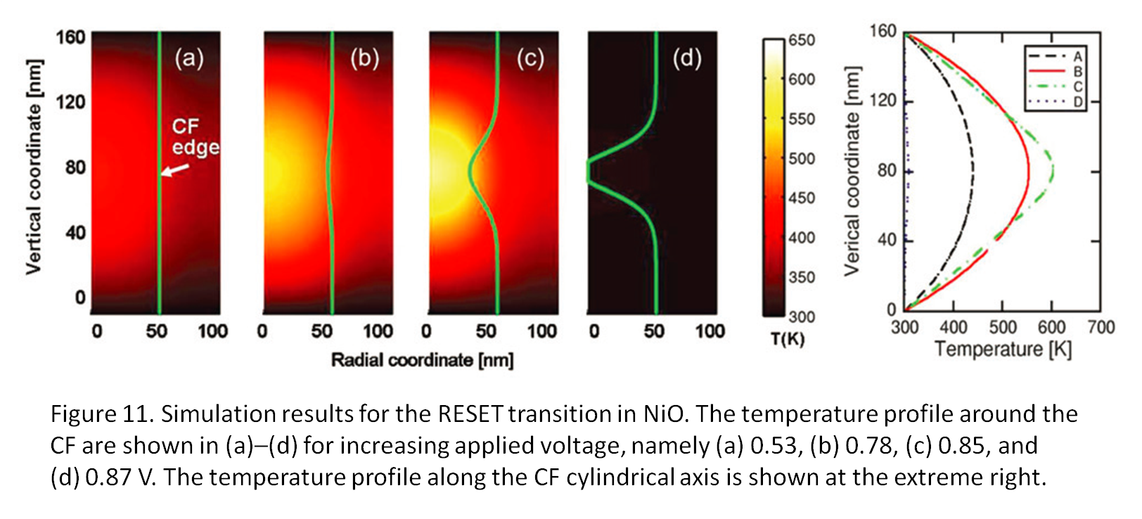

Hi Ivar,
thanks again. I will try to be clearer in this email.
Imagine a filament sourrounded by a second material. Current is flowing and heating the filament as well as the other material. However, most of the current flows inside the filament, then it should heats up more than the other material.
In particular I have a temperature field at the boundary between filament and sourrounding material.
What I need is to change the geometry of the filament (it shrinks its diameter with a velocity which depend on the temperature, something like dr/dt = f(T(r), t), with r= radius of the filament at time t) and T(r) the temperature at the boundary.
In theory after a certain time the filament should break as the filament in a light bulb, however I know that this is a topological change of the geometry and could be difficult, I just need to know the velocity of filament shrinking at different sweep velocity of the bias in time and as function of maximum bias reached (imagine to apply a triangular bias weep to the device: the sweep reaches a maximum bias in a certain time).
The volume left empty by the filament shrinking is filled by the sourrounding material...in other words the boundary between the two materials should change in time with the function dr/dt = f(T(r),t). I attach a figure with caption took from a paper that make a similar simulation. In the figure the green line represents the variation of the filament diameter in time (at different biases) as a function of the thermal heating. The more the filament heats up, the faster the diameter drops. the figure comes from (Phase Transitions Vol. 84, No. 7, July 2011, 570–602).
I wonder if something similar could be implemented within COMSOL 4.2. I have a discrete understanding how to couple the thermal and electrical parts, but for the inserting of the dynamic change I really don't know.

if you can express the thermal shrinking as a negative thermal expansion, normally the TS would take that, depending now if the linear material behaviour is correct for your case, there are other models in the non linear material section.
Indeed as you have large deformations, at least the geometric non-linearities should e turned on, but perhaps you are better off with a fluid approach and ALE, but then you need to have your material properties accordingly, and I'm not sure the volumetric thermal expansion/compression DoF for fluids is implemented in COMSOL (yet ?)
Hi if you can express the thermal shrinking as a negative thermal expansion, normally the TS would take that, depending now if the linear material behaviour is correct for your case, there are other models in the non linear material section. Indeed as you have large deformations, at least the geometric non-linearities should e turned on, but perhaps you are better off with a fluid approach and ALE, but then you need to have your material properties accordingly, and I'm not sure the volumetric thermal expansion/compression DoF for fluids is implemented in COMSOL (yet ?) -- Good luck Ivar

thank you very much for the many advices. Actually I menaged to get what I wanted using partially this thread and partially another one (I don't remember the exact title) where you explained how to simulate the bending of a capacitor induced by the charge!
I used ALE (on top) coupled to EC and HT simulations, putting a temperature dependent formula on the boundary between the two materials. And it works!
there is still a lot of work to do to generalize in 3D, get all the right parameters, but I think I am on the right track.
