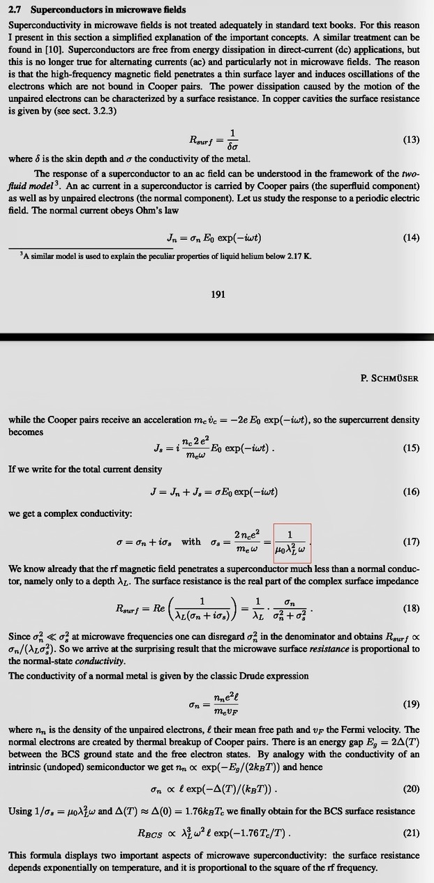

Trying to model a superconducting microwave resonator. The model I have attached has the conducting plane material with a very high electrical conductivity (10^99 S/m). Also the Perfect electric boundary condition is used on those boundaries. In real world application, these selections might not be the best choice to model superconductivity as there might exist some Kinetic Inductance due to the Cooper pairs. For this I thought to add a complex valued electrical conductivity (purely imaginary, j/mu_0const(λ_L^2)2pifreq) to the material. So,
Just by adding a purely imaginary complex conductivity to the material instead of 10^99 S/m will be okay (PEC stays)?
