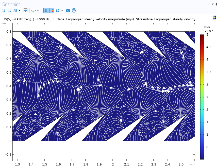

                                                    Hi Edgar,
Thanks for the response. That definitely makes sense and seems to be solving as intended now in terms of getting stationary results for each frequency, but I am getting some very weird results that are different to when I solved them in two separate studies. I am unsure if this is due to it solving the physics differently/wrong but it is definitely different to the results I get when solving in separate studies (which agree much more with literature). I have attached the streamline plots underneath. As far as I can tell the study step itself is identical to the one I used  when they were separate studies so I'm a bit lost as to why there is such a big change. Thansk again for your help.
Cheers,
Ricky

                                                    Weirdly enough I just restarted a new study to see if there was some hidden setting I'd accidentally changed somewhere in the old version everything seems to be working now which is a bit weird but I'll take it. Thanks for the support!
Cheers,
Ricky
