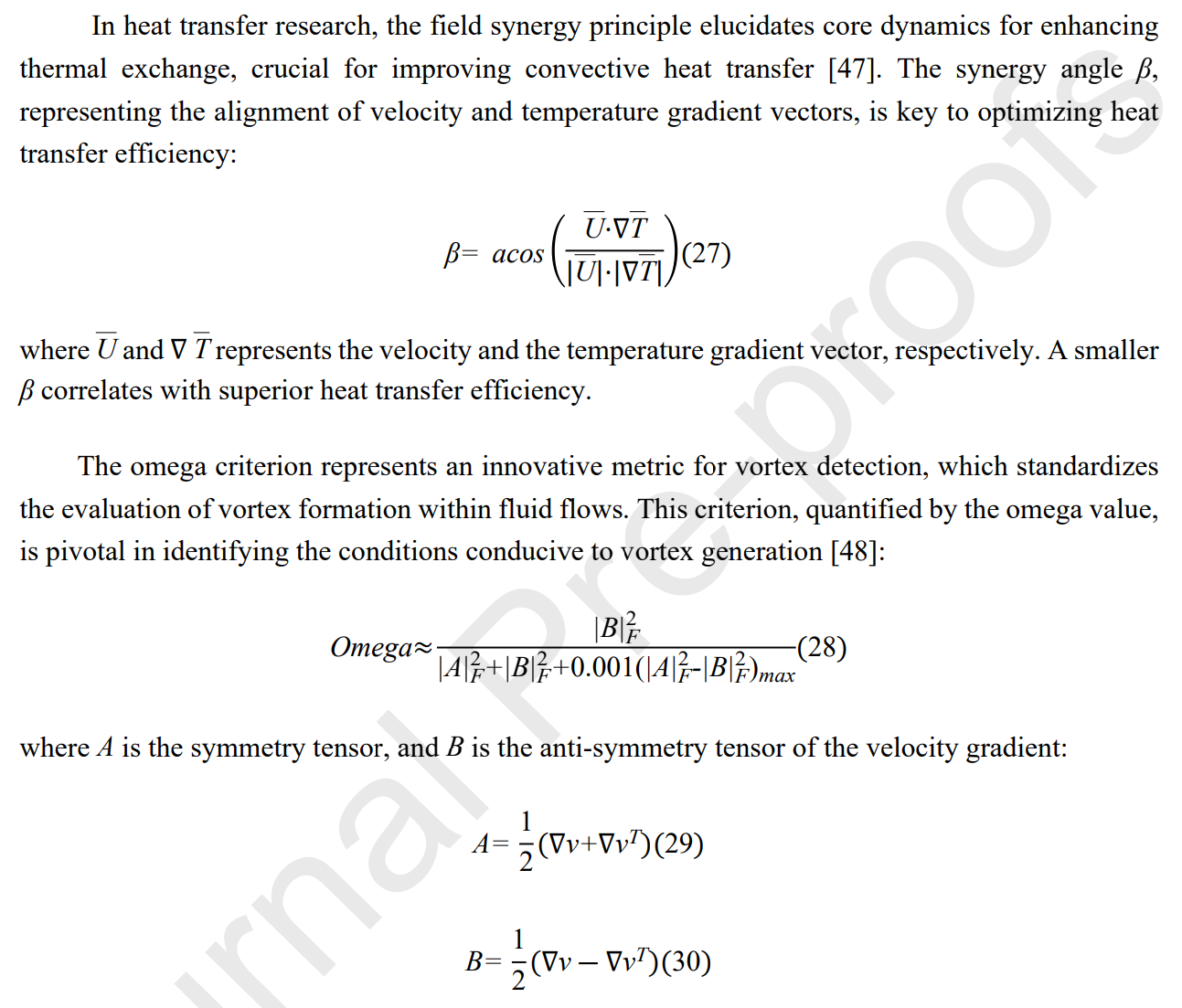

Hi, I'm glad to be able to ask for advice. For the post-processing part of the results of comsol, we want to implement the field synergy principle and omega vortex. But we don't know how to do it, so please guide us. The formulas for the two principles are shown in the figure.
