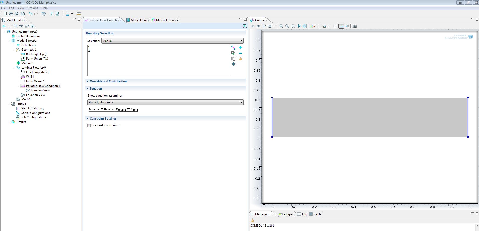

check the "equation" tab of your periodic boundary condition node, for me it's written out fully thereunder (the tab is closed by default, except if you have enabled the default showin of the equations).
I find it useful to regularly check the equations it helps understanding whree you are and what you need to do, possibly help you identify errors in solvers, particularly for multi-physics since all physics do not accept all solver combinations
thx for the reply. I had checked the equation view, but there it says only that the continuity or antiperiodicity condition, respectively, corresponds to var_source=+/- var_destination -- thats clear so far, but does not help me in knowing about any consequences for the flux of var or how to implement inflow=outflow if it is not already included :(
Sabine
in PDE view you have the option for continuity or symmetric, and antisymmetric periodic conditions (4.3a), which means you flip the sign of the flow over the boundaries. This does NOT show up in the equation that remains static, but if you dig into the under-laying COMSOL equations you will see that you have a "-u" instead of "+u"

by default COMSOL proposes "u" as dependent variable for a new PDE physics, but depending on how you rename it it might have anoher name.
Turn on the preferences equatin views andlook at the COMSOL equations
I know many persons prefer to click to link in phenomena but stll , often it's worth to take a look at the equations generated
in SPF I agree, you do not have the symmetry/antisymmetry condition as an option, then use rather inlet and outlet and a coupling variable
