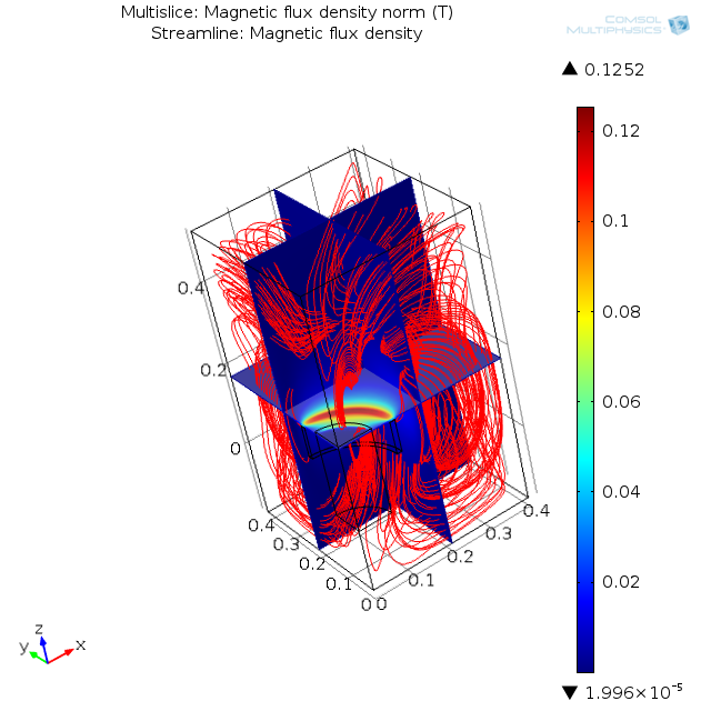

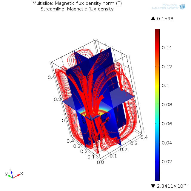

                                                    When I add an Ampère law on the gas domain results change
it gives more power dissipated in core with mef, around 50 % more, and about the same power dissipated in the coil
Thank you again
