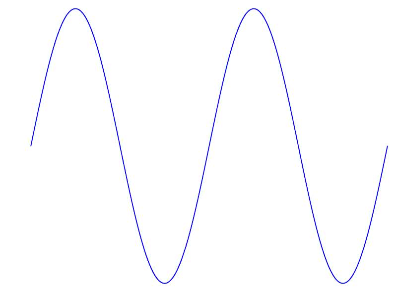

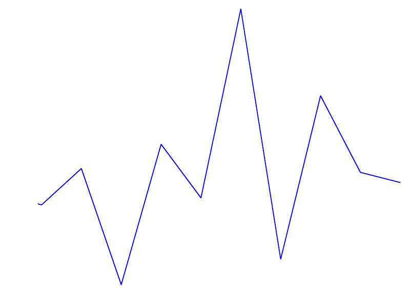

Sorry to ask once more.
I defined a waveform funciton as wv1
( amplitude 5 (no unit), angular frequency 50*pi; phase 0 )
and I can draw it's waveform with amplitude 5( no unit, does that mean 5V).
And I define a global parameter as Vdc = 5* sin( 50 *pi ) [V], I can plot it's waveform
in the Result section using 1-D global, and the result is a discrete sin waveform.
When I use wv1(t) or wv1(t[1/s]) as a parameter to replace the global parameter Vdc,
the Result is a non-uniform waveform , especially the amplitude is very small.
Please see the attachment pic.
Also, the runtime of COMSOL is much much longer when using wv1.
Thanks !
Wang Jiujiang
I do not understand your "without argument" a function must have a argument otherwise its simply a parameter
COMSOL does not propose any "argument" but expects you to provide one
You should read the wv1 node as
Amplitude*sin(Angular_frequency*dummy_argument+Phase)
and you call it i.e. with a wv1(t[1/s])*1[m]
note the units wv1 expect an argument that is unit-less and provide no units so when used you must normalise the argument to a number and multiply by the amplitude units
You should plot your function to check it, then you will notice that COMSOL uses a default argument "t" time for the horizontal axis. but
(COMSOL developers you are floppy here !!)
for some unbelievable reason COMSOL does not propose any names nor units for the default plotting of functions !
this is rather poorly done, I find,as they have everything, and it would be far clearer to write out fully: "wv1(t)" for the plot title and "t" for the horizontal axis and "Amplitude" for the vertical axis titles
