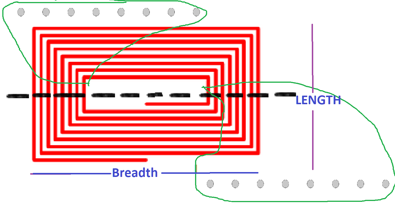

Can anyone help me with the modelling of Rectangular structure in 2D Axi-symmetric model??
As per my knowledge, 2D Axi-symmetric model gives the correct results for system having Cylindrical symmetry. How can I perform modelling of rectangular structure in it??

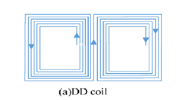

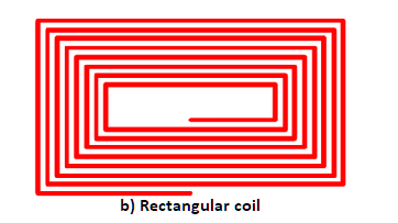

I am attaching the figures of two different kinds of rectangular coils. Can anayone help me??

This cannot be modeled in 2D axial symmetry.

You might want to consider a 2D cartesian model.

If I model the Rectangular structure using the 2D structure, how can I consider its breadth??
I know that we can define the depth in 2D model, so I can define radius and length easily. what about its breadth ??
how I can consider the breadth of the rectangular coil??
a photo is attached for the reference.
>You might want to consider a 2D cartesian model. If I model the Rectangular structure using the 2D structure, how can I consider its breadth?? I know that we can define the depth in 2D model, so I can define radius and length easily. what about its breadth ?? how I can consider the breadth of the rectangular coil?? a photo is attached for the reference.
