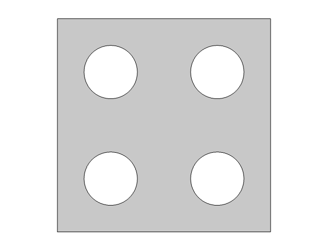

What Comsol options should I use to properly define periodic boundary conditions (PBCs) for solids with uniformly distributed cylindrical holes? Unit cell is presented in: (unit-cell-1, unit-cell-3)

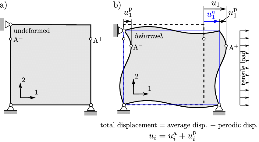

Applied load in one direction does not influence other sizes of unit cell. Why?
Example 2.
https://www.comsol.com/blogs/analyzing-a-unique-poroelastic-metamaterial-with-simulation
In second example deformed unit cell is still cubic box.

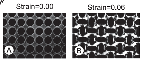

Sometimes it is not possible. See attached figure unit-cell-4.
How to make boundaries deformed after PBC will be applied with loads?
