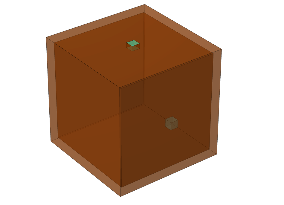

I am modeling a heating device placed inside a room using conjugate heat transfer module with k-ε turbulence model.
The simplified geometry consists of three cubes (figure attached), the smallest cube represents the device, which is placed inside the room very close to two walls. The air inside the room is defined using the second cube, and the difference between the biggest cube and the second cube is defined as a brick wall. The heating device is at a constant temperature of 100 degC, and there is a constant air inlet (mass flow rate defined) from the top face of the device. To make it a stable system, an opening is made in the roof (as seen in the attached picture).

The issue with it was that the solution was not converging as there were no adequate inputs defined to govern where the fluid would go in the turbulent flow module. You could use a pressure point constraint or define an outflow condition to make it work.
