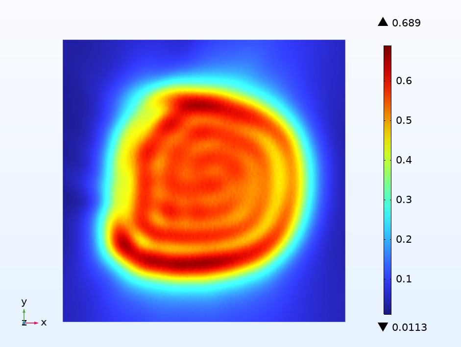

Electric field plot

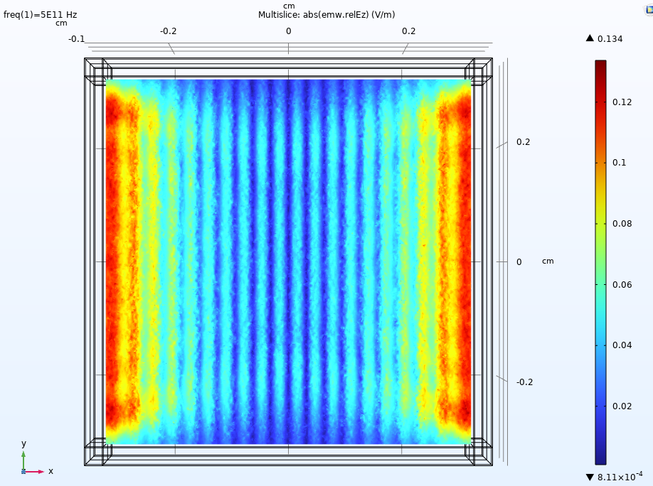

Hi, I am using the scattering field formulation for my model. I am using an x-polarized negative z-propagated plane wave as my background electric field. My structure is a box consisting of an air domain(top) and cancer domain(below). I used scattering boundary conditions. After the simulation, I realized that 1. emw.normE = abs(emw.Ex) 2. but abs(emw.Ez) is not = 0. if 1 is true, then how is 2 possible(since i am propagating the z direction anyways). or i am not plotting it correctly. I have attached my file. Thanks

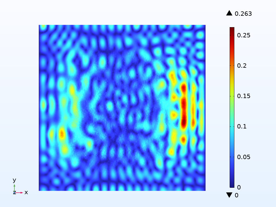

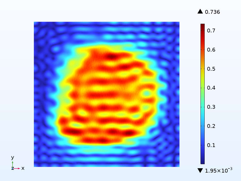

Posted: 2 years ago 2024/09/04 8:23 GMT-7

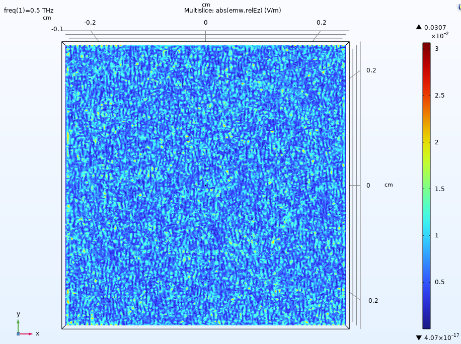

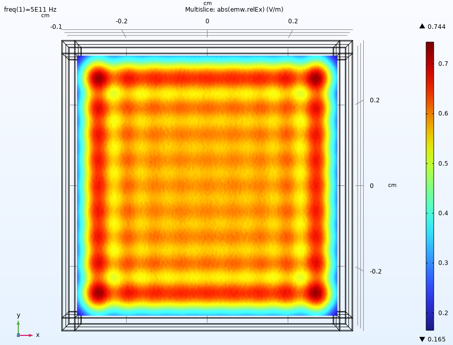

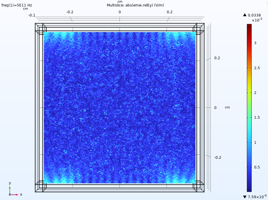

I was asking a physics question to relate it to computational. So for example, the model that you just helped me with, when i plot the abs(emw.relEz), i get 0.26 V/m amplitude while the abs(emw.relEx) gives 0.78 V/m. This makes the Ez component quite significant here. This is the reason for my question. can this be a simulation noise or something? If so, is there anything you recommend can help fix this?
Posted: 2 years ago 2024/09/04 8:58 GMT-7
Updated: 2 years ago 2024/09/04 8:59 GMT-7
The scattering boundary conditions on the sidewalls are not really correct for this configuration. If you replace them with PECs on the walls normal to the x axis, and PMCs on the walls normal to the y axis, then those will cleanly fit the example incident plane wave and you will see the Ez component nearly vanish. If you are interested in exploring a non-normal angle of incidence, you may have to introduce some other boundary condition, such as perfectly matched layers, or even appropriately periodic conditions, such as Floquet boundaries.

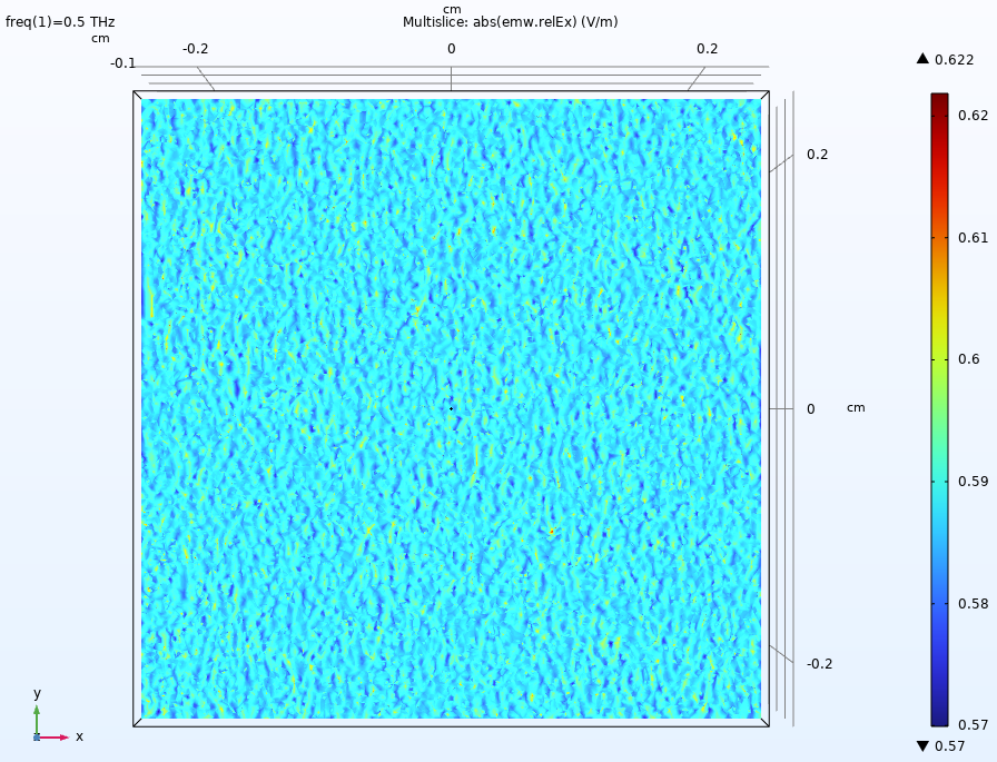

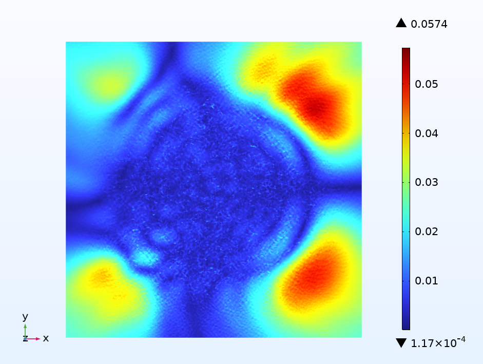

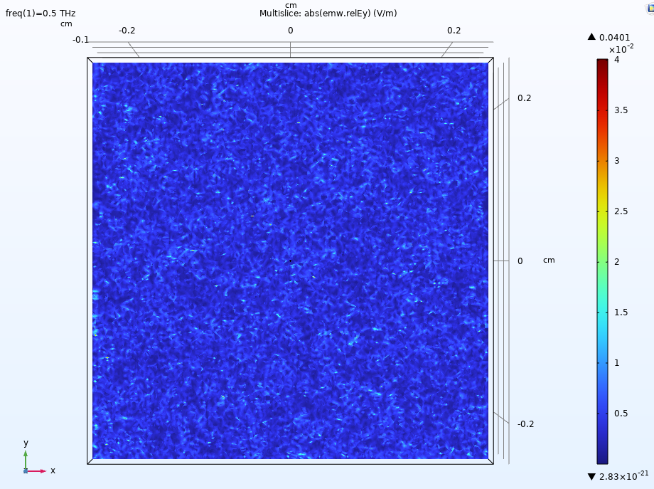

Posted: 2 years ago 2024/10/01 10:21 GMT-7

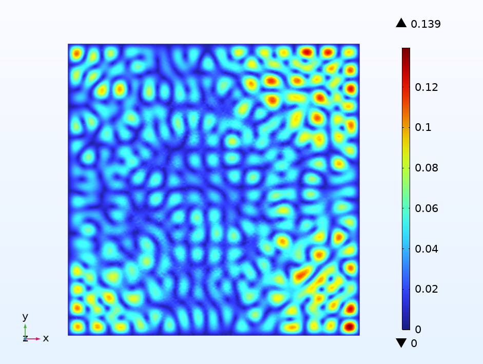

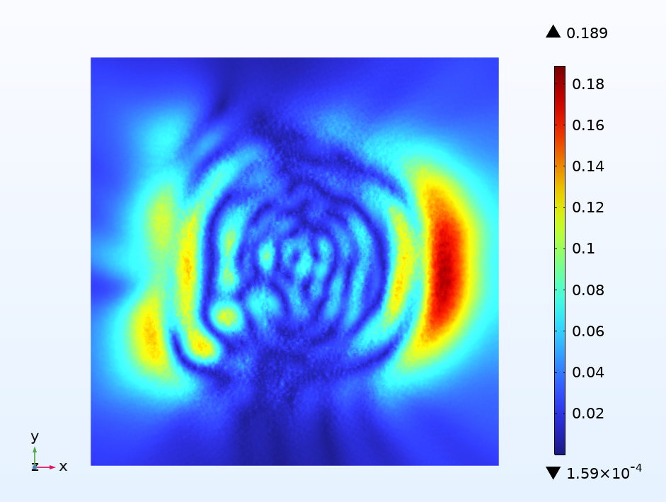

  • Hello sir, I used your suggestion on my problem above. I investigated both PEC/PMC boundary conditions as well as PML. I realized that PEC/PMC gave me the results I expected but the PML results is questionable. I wonder if I did something wrong using the PML. My geometry will become complex in the future so I dont want to rely on PEC/PMC . Is there anything I should do? I have attached my files and results . I welcome your suggestions.Thank you.
* Hello sir, I used your suggestion on my problem above. I investigated both PEC/PMC boundary conditions as well as PML. I realized that PEC/PMC gave me the results I expected but the PML results is questionable. I wonder if I did something wrong using the PML. My geometry will become complex in the future so I dont want to rely on PEC/PMC . Is there anything I should do? I have attached my files and results . I welcome your suggestions.Thank you.

My wave is at normal incidence so the PMC/PEC walls was valid. However, my goal is to simulate a structure like seen in the attached file, called figure. Initially when I used SBC and PML, I was getting electric field components in the Z.which was what i did not understand since my plane wave z propagated. My initial guess was that, my structure might not be flat. This is why i decided to use a simple flat structure as I have shown in our previous exchange. I was getting Ez components which was solved when i used PEC/PMC walls. However, when I used PEC and PMC walls, on my real geometry (figure), the results gets worse. I even get Ey and same Ez component. The PML works better on my real structure than PEC/PMC. I am just trying to understand why I get Ez components regardless of what i use. And since my structure will get more complicated, I dont want to rely on PEC/PMC walls. Please refer to the attached files for confirmation. I couldnt get my .mph files to be less than 5MB, so if you need to review that, I can send it to you anyhow you prefer. Thanks.
