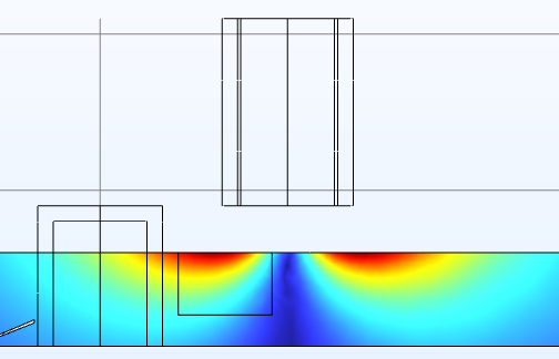

I am building a model using the AC/DC module with frequency domain analysis. I have a homogenised coil with many turns situated above a 1.5mm layer of CFRP, then underneath that there is a 3mm layer of Aluminium. The aluminium layer has a cuboid region cut out of it, which one half of the coil is located above. The cuboid region was created by subtracting a cuboid from the plate, which then leaves a region that isn't allocated as aluminium and therefore defaults to air. I have double checked and the region is indeed air and is not overriden by any other material.
However, the Eddy currents produced in the Al layer are clearly just flowing straight through this air region as if it wasn't there and it was all just part of the Al sample. In the screenshot attached, the slice runs directly through the centre of the coil and air region, which is the square directly under one half of the coil. It clearly shows the current just flowing straight through it, which isn't physical. The "n-shaped" object to the left of the air region is a Ti rivet, which should also have some impact on the current, but it doesn't seem to.
It looks like COMSOL is considering the entire sample to just be one solid block of conductive material, but I've checked and double checked my material assignment and I can't see why this should be the case. Can anyone offer a possible solution please? Thanks in advance!

I added an Ampere's Law node that overrides all the Free Space assignments and set the conductivity for air and the dielectric to 1 S/m for solver stability. Now the result looks realistic.
I think the Free Space thing is relatively new and I never used it. I always use Ampere's law with suitable material assignments. Free space is essentially equivalent to air. The Free Space node should actually just add the stabilization conductivity that is needed to get the solver to converge. But maybe I am missing something.

The reason for the lack of material contrast, is that everything is free space. Adding materials to the model gives COMSOL access to the necessary material data, but it does not specify how to treat the domains. In the physics, the default node is "Free Space" (vacuum/air), this node serves as a canvas. You can add an "Ampère's Law in Solids" node to indicate that your metals are solid (basically; what Edgar says -- see attached).
The reason for this design is that for electromagnetical phenomena (in particular related to anisotropic material properties and eddy currents) the behavior of liquids and solids is conceptually different. Since making everything liquid or solid by default would result in models that are wrong in one way or another, we decided to start with empty space and encourage the end user to make a decision.
On top of this, the free space node comes with built-in stabilization. That is the reason why you got some current in your initial model (although a very small amount). On the forum you may have seen the general advice to use "1 S/m in the air". The free space feature determines an appropriate amount of stabilization conductivity automatically, by looking at the local skin depth.
We've been experimenting with this design for about one release now and your feedback shows that for some use cases this can lead to confusion. We will look into this and improve the usability in this regard.

The Free Space is the default domain feature in the Magnetic Fields interface since version 6.2. It is there to automate the modeling of free space (non-conducting media with relative permittivity and relative permeability of unity). Depending on the frequency, some artificial conductivity is needed in such domains and the Free Space feature is there to automate that.
The Free Space feature must be overridden by the user in domains having a (non-free space) material by adding Ampère's Law in Solids or Ampère's Law in Fluids - otherwise the entire simulation domain will be treated as free space.
The reason for having two flavors of the Ampère's Law feature is to be able to correctly handle models with moving parts/mesh as then solids and fluids must be treated differently.
When adding Ampère's Law in Solids to your non-air domains (above the Coil as the Coil also overrides Free Space and is overridden by Ampère's Law in Solids), the solver warned for some missing material properties in the CFRP_homogenised material (permittivity and conductivity) so I added, hopefully intelligent, guesses for those see the attached version.
