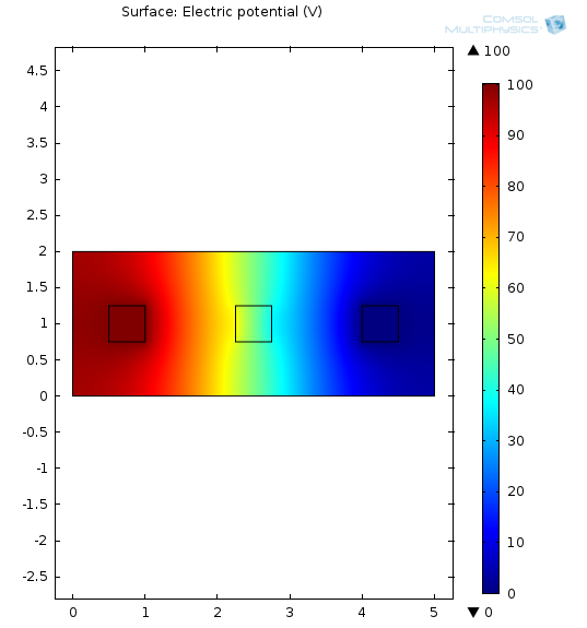

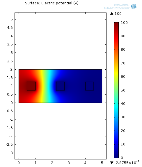

I have attached two different models of 3 copper "terminal" like objects in the middle of a relative insulator. I want to see the electric field and potential field mapped onto the geometry. One model uses the Electrostatics Interface and the other uses the Electric Currents Interface. Each model has a potential on the left terminal, ground on the right terminal, and nothing assigned to the middle terminal. Theoretically, the voltage should vary linearly from the potential to the ground with a little glitch in the linearity over the middle terminal. This is what the file "Electrostatics_ForumQuestion.png" file shows, which is the correct one. The other picture file "ElectricCurrents_ForumQuestion.png" shows an incorrect interpretation of the model (a non-linear change of the voltage with respect to the distance between the potential and grounded terminals). I have also included the corresponding Comsol model files for each one if you would like to see more.

For the electric current problem the conductivities appear in the equation, whereas in the electrostatic problem it is the permittivities that appear. The permittivities of Copper and Nylon are close in values, whereas their conductivities are about 18 orders of magnitude apart. This results in completely different looking solutions. If you change the value of the conductivity of Nylon to be similar to that of Copper in your electric current model, you will get a solution that looks similar to that of the electrostatic problem.
Hi John, For the electric current problem the conductivities appear in the equation, whereas in the electrostatic problem it is the permittivities that appear. The permittivities of Copper and Nylon are close in values, whereas their conductivities are about 18 orders of magnitude apart. This results in completely different looking solutions. If you change the value of the conductivity of Nylon to be similar to that of Copper in your electric current model, you will get a solution that looks similar to that of the electrostatic problem. Jeff
