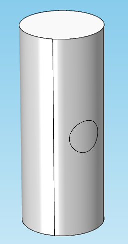

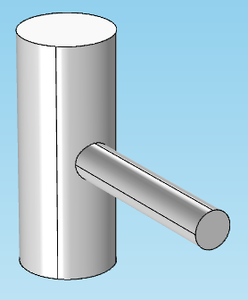

I don't have v3.5 so I'm not sure if you can do this or not, but here's how I'd do it in v4.3a:
Add the 1st cylinder
Add a 2nd cylinder perpendicular to the 1st that intersects the 1st where you want the circle to be
Use Conversions>Convert to Solid and add both cylinders to the selection list. This will generate the imprint on the face of the 1st cylinder where these cylinders intersect
Add a Delete entities node and delete the 2nd cylinder which you don't need any more.
See attached screenshots for the idea.
This should work for you.

Well, if you don't have a "Delete Entities" option. You may be able to use the "Split" command to divide the object into separate objects and then use the delete button on your keypad to delete the unwanted cylinder. Hope that works.
