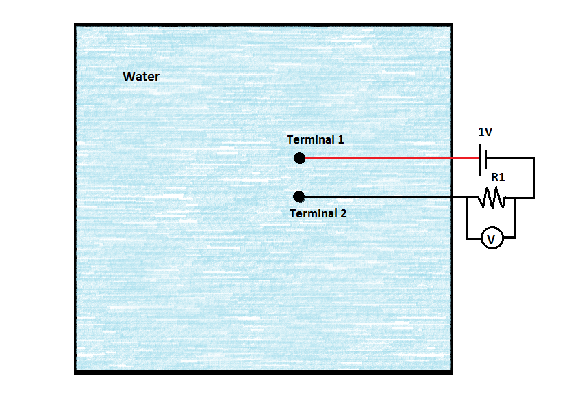

I am relatively new to COMSOL. I am trying to simulate a two part problem.
1. An electric pole is placed underwater
2. A circuit is built around it to measure the voltage drop across a resistor
The setup can be better understood from my schematic that I have attached.
I have done the first part in which I ran the Electrostatics Physics and got the potential plot. From different posts in this forum I was able to make a little headway into the second part, but it does not work. I assigned two terminals 1,2. Added a voltage source between 1 and 2. Added a External I vs U between 2 and 3 and then a resistor of 10000 ohm between 3 and 0. When I try to solve this, I get the following error
Errors during multiphysics.
The DAE is structurally inconsistent.
- Variables: 2
- Equations: 0
I have attached my files.
The reason may be that the two terminals are not connected. But the water should technically close the circuit. And there should be a reading on the voltmeter. I have verified this experimentally to be of the order of 300 mV. But COMSOL does not solve my problem. Is there something that I am doing wrong or COMSOL is not designed to solve such a problem.
Any help will be highly appreciated. Thanks.

I believe you have a GND issue, you add one GND and one terminal on your EC physics, (remember a GND is just setting a "gauge" potential. Then you add a circuit, by dfalt 0 is GND (andimplicitely already connected to your other physics, 1 is floating, until you connect up a source, if its a AC voltage you must define it accordingly and then connect it with a Circuit source term onto the terminal 1 in your EC physics. Now, as I'm not by my workstation I cannot open your model, so either you have another circuit for the measurement, hence a sencond terminal fixed to some other electrode, here you need to link it to your CIR circuit via a specific source or sink node attached to a CIR ID of 2 (since 0 is GND and 1 is the potential source, and select to connect the twophysics boundary links, then you must add your load resistor between 0 (GND) and 2 your return from the circuit.
COMSOL proposes automatically the lumpoed parameters in the Derived Values list for your terminals
Note in AC use the frequency harmnic solver and do not forget to fix your frequency or list of frequencies in the solver tab.
Final note, there is no real eason to use CIR also for the source, you could as well define the voltage amplitude in the EC terminal physics, and simply add a ressitor between 0 and 1 in the CIR and use node 1 to link to the second "measurment termainal in EC.
If you want to learn something, for a simple resistance, remove fully the CIR physics, and connect the average current on your otherwise terminal node to the GND via a weak expression ;)

Thank you for your reply Ivar. Unfortunately I could not get it to work still. I think what I had done was same as what you tell. Or at least it seems the same to me. But as before, I am getting the "DAE is structurally inconsistent" error. Is it possible for you to take a quick look at my files from before. I think my issue is that my circuit is not able to correlate electrostatics nodes with its own nodes. I think that is where I am doing wrong.

There were two problems in your setup:
1) The circuit was not connected to the Electric Currents interface. The External I vs. U node should be used to make this connection. The voltage specified on this node should be equal to the potential difference between the two electrodes.
2) The circuit components did not form a closed circuit.
The implementation is simplest if one of the electrodes is grounded. See the attached file for a corrected setup.

I've attached a file in 4.2. I noticed that the coupling in the previous file (using the drop down menus) was not working correctly, so this file has the variable names manually entered on the Terminal node and the External I vs U node. Note that you need to enter the length of the wires on the Electric Currents node (the default is 1 m).

This one works. Perfect. Now I see what one needs to do for such a problem. Thank you very much Luke.
