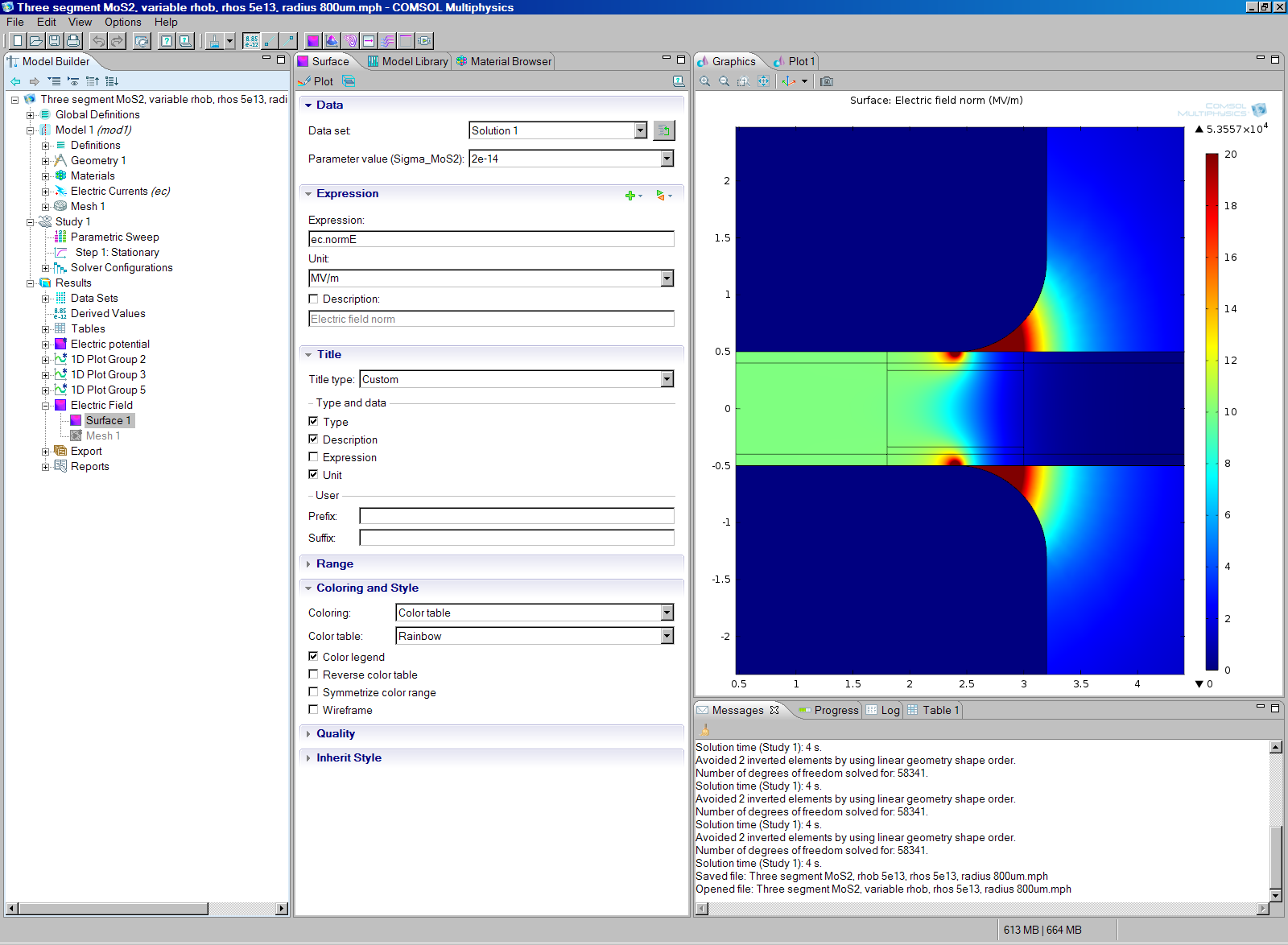

I've made a model of a hi-pot test setup to visualize how the electric field changes at a discontinuity as the conductivity changes (fixed potential).
I'ts working great, but now I want to make an animation of the results. I can create the series of 2D plots without a problem, but I don't know how to show the value for the conductivity on the plot, making it difficult to distinguish between them.

Just to be sure. Did you click on the head Plot Group node and click the Solution check box under Title? The reason I ask is because I see that your screenshot shows that the Surface plot node is selected rather than the parent node.
