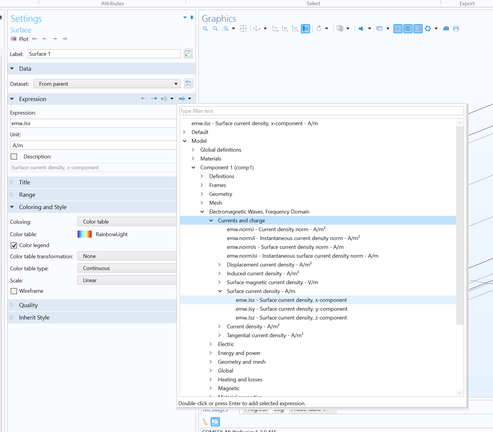

OK, I'm going to assume that you are using the RF module in 3D and that you have set up everything properly in your model, meshed it, and executed it, so now all you want to do is plot some of your results for the surface current density. In the Model Builder, right-click Results, and select 3D Plot Group. A 3D Plot Group will appear in the list. Right click on that, and choose Surface. Surface 1 will appear in the list. Right click on Surface 1 and choose Selection. Go to the Settings pane. Select the specific surfaces of the antenna on which you want to plot your surface current density (you can select them with the mouse). Now go back up one step to Surface 1 and look at the Settings panel. Choose (or type in) the component of surface current density that you would like to plot. See the attached screen shot, in which I've picked the x component of the surface current density (which is called emw.Jsx) to plot. There are also many other computed quantities you can plot. I hope that helps. If you've computed the results at more than one frequency, then you'll also have to pick the frequency of interest to plot. If you are unsure about how to do that, I suggest you look at some of the provided Application Library examples and also work through some of the tutorial examples.
