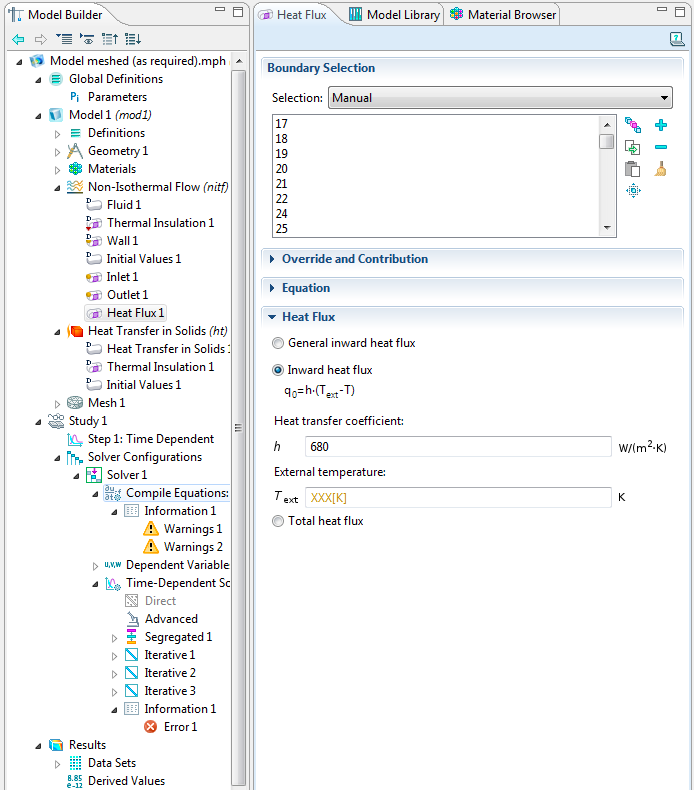

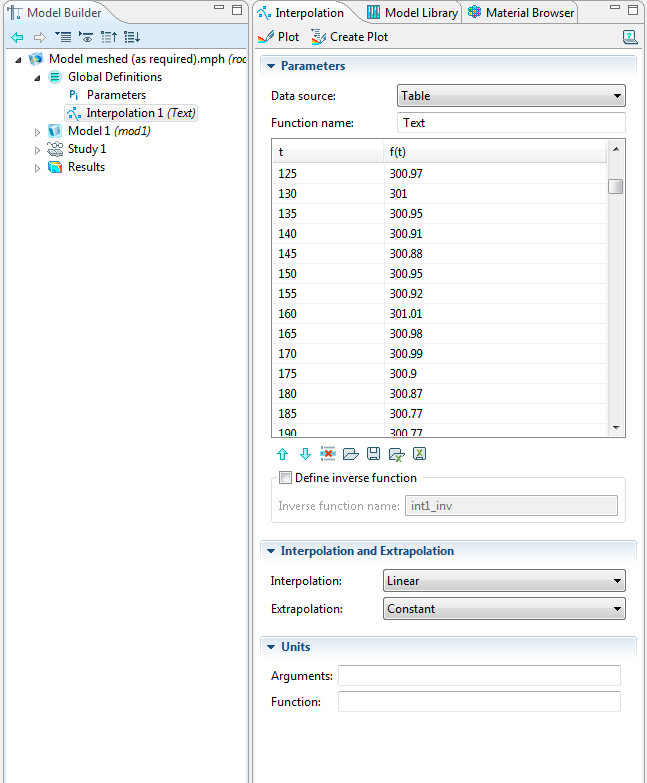

But sir, I have created an interpolation as in the image for ambient temperature. where t is time and f(t) is temperature at that time. I wish to use this interpolation in inputting the T(ext) at heat flux as the outer walls of my model will be affected by ambient temperature. Can you let me know how to solve the above problem??
Please help sir...
[QUOTE] Hi you can replace your XXX with something like T0[K]+DT[K/s]*t where T0 is a constant scalar representing the initial temperature in Kelvin, and DT is the temperature increase with time (the numbers and units are typically defined in the Parameter section with the Parameters T0 and DT) -- Good luck Ivar [/QUOTE] But sir, I have created an interpolation as in the image for ambient temperature. where t is time and f(t) is temperature at that time. I wish to use this interpolation in inputting the T(ext) at heat flux as the outer walls of my model will be affected by ambient temperature. Can you let me know how to solve the above problem?? Please help sir...

have you tried with Text(t[1/s]) the [1/s] is to transform the variable t with units into a "pure" number expressed in seconds
Hi have you tried with Text(t[1/s]) the [1/s] is to transform the variable t with units into a "pure" number expressed in seconds -- Good luck Ivar

while the solver steps through the transient study, going from your first to the last value, it will, for each new time step, calculate the value of Text(t) you have given, it will interpolate between the values
Hi while the solver steps through the transient study, going from your first to the last value, it will, for each new time step, calculate the value of Text(t) you have given, it will interpolate between the values -- Good luck Ivar
