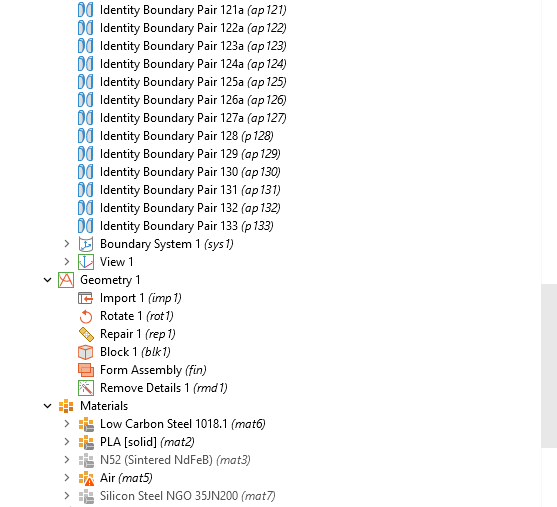

After importing my file, I rotated it 45 degrees, placed a repair node in (from right clicking on Geometry -> Defeaturing and Repair -> Repair), and placed a block around the model (to simulate air around the model). I started with Form Union, but when I rendered my mesh, it gave me multiple errors because the Solidworks model is too complicated, so I proceeded to use Form Assembly. In the form assembly tab, I have "create pairs" selected, and the pair type as "identity pair".

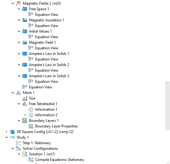

Moving down to the magnetic fields interface, I noticed that when placing the node in, free space, magnetic insulation, and initial values are all defaults. Moreover, the magnetic insulation component selects every face inside the box (which is meant to be a magnetically permeable material) and the box itself (which is air). I add in Ampere's Law in Solid's to select the parts inside of the box that are supposed to conduct magnetic fields with the selection "Magnetization" highlighted with a given material magnetization, but when I run my simulation, I run into an issue where the flux is near zero (on the order of E-16 teslas) which makes sense because the tangential component of the fields on the parts of the model that are supposed to conduct magnetic fields are forced to zero; given Gauss' Law for magnetic fields the magnetic field should be zero. Therefore, the fields don't permeate outside of the model.

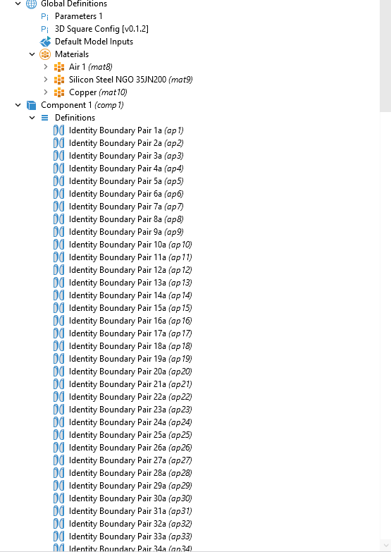

Given that, I went and checked under "Definitions" to see the Identity Boundary Pair, and it made pairs between each of the components in the assembly. After running it again (where the Magnetic Insulation is still selecting everything inside the box), I run into the same issue. I then try to implement a Continuity Boundary in the Magnetic Field's interface, and I see that all of the components inside aren't selectable (it says "not applicable"). So i then try to select all components inside of the box and add a Magnetic Field's boundary condition, assuming that COMSOL will recognize that if I keep the initial parameter of the boundary condition of the tangential magnetic field to be zero, it will allow the magnetization to conduct in the material.
I either get an error message that says: Divergence cleaning failed for Auxiliary-Space Maxwell (AMS), or I run into the same issue where the magnetic flux doesn't permeate out of the material inside the box of air, and the magnetic field is still around the value of E-16 Teslas (essentially zero).

I attached a picture of my Model Builder Hierarchies, however, I'm not able to link my COMSOL model due to privacy concerns. Could anyone help me?
Edit: I have one section of my model to be a magnetization-based solution, so i set the magnetization myself, and another section is to be influenced by such magnetization, which i set the magnetic properties to be the material's relative permeability. When i run it as is, I get the AMS error mentioned above. When i set both components to be magnetization, it runs fine but it's not what I'm looking for. I have a hunch its an issue between the boundary conditions. Could anyone help me solve this issue?
