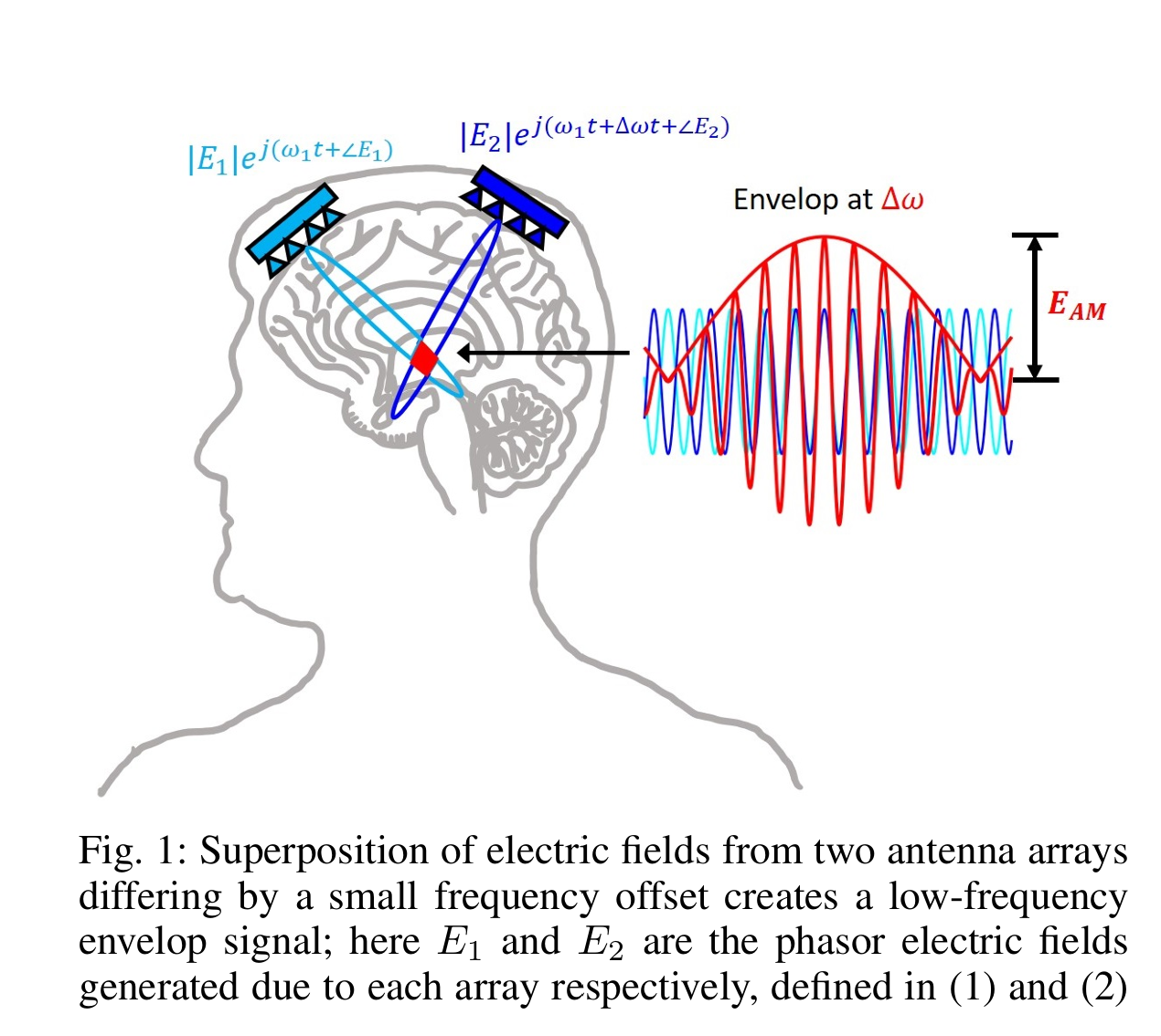

I am attempting to simulate the structure using COMSOL. Specifically, I am trying to excite a two-antenna array, each with four point sources, simultaneously at two different frequencies. However, I am having difficulty figuring out how to achieve this in COMSOL, as the tool is relatively new to me. I also tried combining the results of frequencies F1 and F2 in post-processing, but the outcomes seem incorrect.
Could you kindly guide me on how to approach this in COMSOL?
P.S: I mean antenna 1 with F1, and antenna 2 with F2 simultaneously.

First, you need to make sure that you actually get the mathematics of what you want to do. In the attached picture it is seemingly a 'superposition of phasors that have two slightly different frequencies', and so that suggests a sum, in which case you can do what Robert says, and run each frequency on its own and then combine studies to get the full solution. But the attached picture also mentions E_AM, suggesting Amplitude Modulation, which in turn would imply a multiplication, in which case you need a time domain solution.
Try setting up two analytical solutions in COMSOL (no FEM), and compare sin(100[Hz]t)+sin(101[Hz]t) and sin(100[Hz]t)sin(1[Hz]*t)
and look at the frequency content of each of them. I sounds like you want to do the former of the two, but make sure.

First, you need to make sure that you actually get the mathematics of what you want to do. In the attached picture it is seemingly a 'superposition of phasors that have two slightly different frequencies', and so that suggests a sum, in which case you can do what Robert says, and run each frequency on its own and then combine studies to get the full solution. But the attached picture also mentions E_AM, suggesting Amplitude Modulation, which in turn would imply a multiplication, in which case you need a time domain solution. Try setting up two analytical solutions in COMSOL (no FEM), and compare sin(100[Hz]*t)+sin(101[Hz]*t) and sin(100[Hz]*t)*sin(1[Hz]*t) and look at the frequency content of each of them. I sounds like you want to do the former of the two, but make sure.
