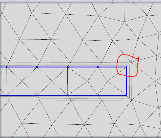

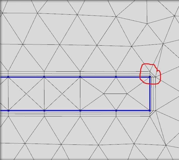

I am trying to mesh a k-epsilon model and cannot generate a boundary layer mesh. My model has a very narrow region and I expect that that is the problem area. The error I get most often is: Could not shift boundary node at all. The first screen shot attached is a view of the narrow region. The second shot shows the internals.

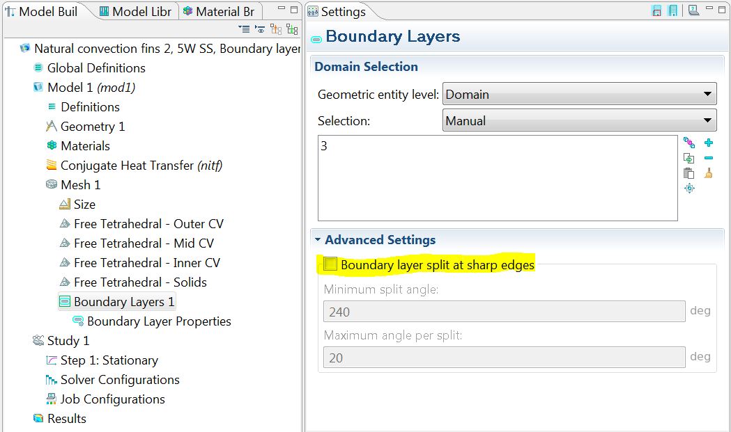

Ver 4.2a ==> uncheck the split boundary layer check box (see pictures attached)

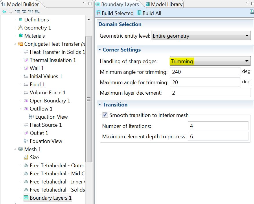

Ver 4.3B==> choose the trimming option from the drop menu /Engineering
