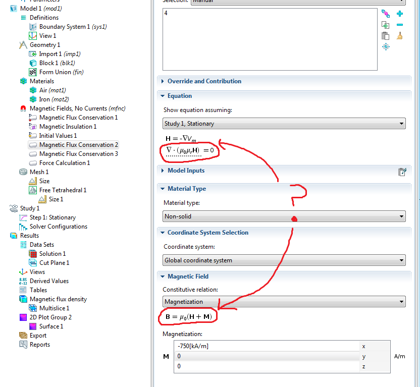

Also, on a side note: when you choose the Magnetization constitutive relation B = u0*(H+M) in Magnetic Flux Conservation, I noticed that the Equation section seems to have a mistake; the second equation listed (Gauss's Law of magnetism) is listed as del*(u0 ur H) = 0 which is the same as what you see for all the different constitutive relations, but since Gauss's Law is del*B = 0, by the Magnetization condition this should instead be del*(u0*(H+M)) = 0. Is this just a formatting mistake, or does the calculation actually use del*(u0 ur H) = 0? Or am I making a mistake?
