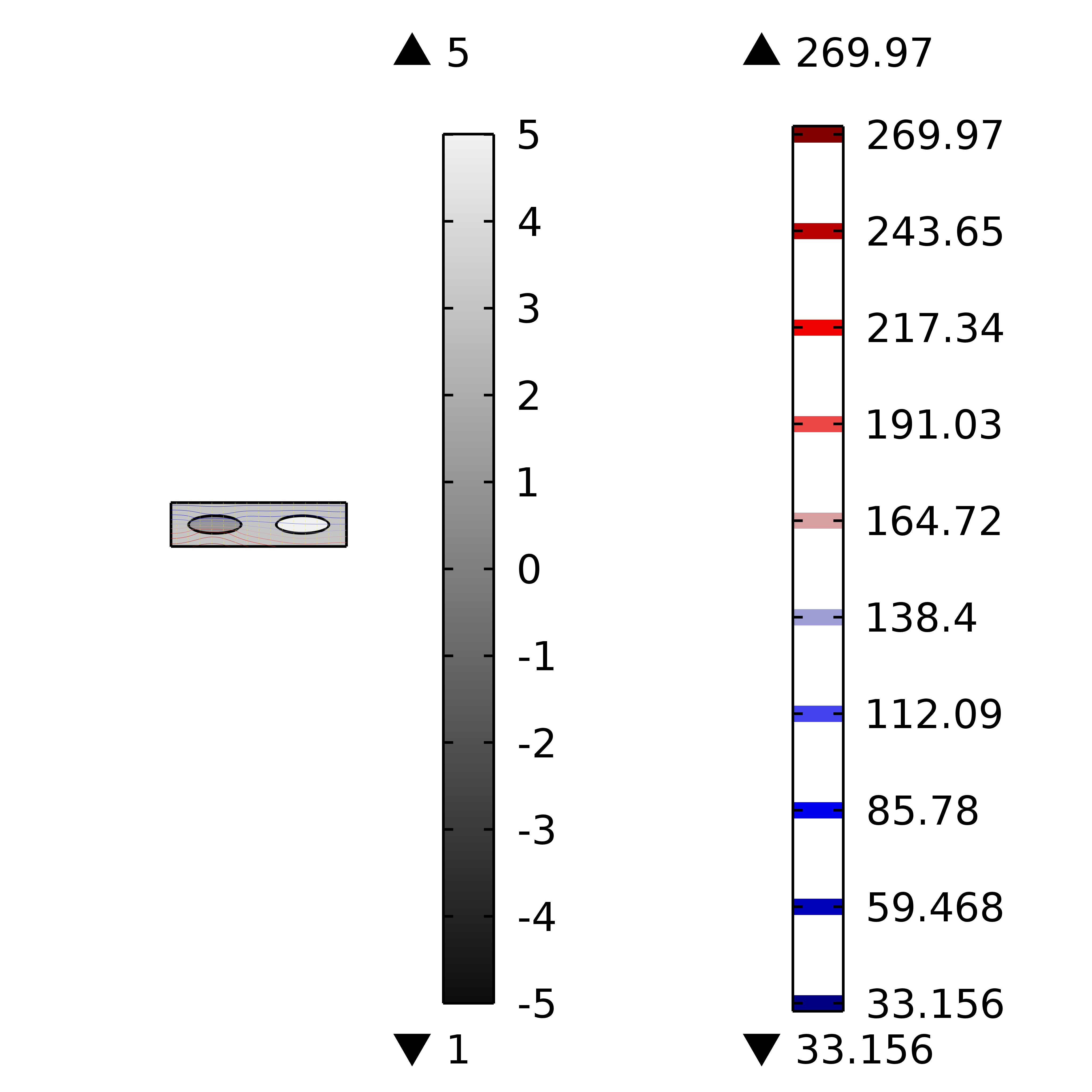

I am using COMSOL 4.2a, and want to use some surface plots alongside legends of the colour tables used. It is bizarre that COMSOL does not provide vector graphics export. I have tried to generate a decent image using the png export (via the 'snapshot' button -- is there any other way?), but it is horrible.
How I am doing it is:
1. Use highest 'Quality' settings in each component of the plot group that has such a setting (e.g. Surface; Contour)
2. Set export resolution to 1200 DPI
3. Set image dimensions to highest possible (for me it seems 4096 pixels is the upper limit?).
4. First generate a snapshot without any includes (i.e. no title, legend, axes. etc)
5. Then generate a snapshot with the legend included.
6. In GIMP cut and paste and scale as required.
See attached file for example of trying to export a surface plot with two colour legends. The model image part of the figure is tiny, and the legends huge.
If anyone has any tips or a separate set of routines in python/matplotlib or similar already in place I would love to see it!

Thank you for your comments and suggestions. In this case I would recommend trying a lower DPI, as this would produce a bigger image (a DPI setting of 1200 and a width of 4096 pixels results in an image just over 3 inches in width). The DPI setting also affects the size of the included extras, a lower DPI setting yields smaller colorbars/legends/etc.
An alternative method that can be useful is to resize the GUI image frame to the desired size before exporting it. In the Image snapshot menu, change the Image size to Current - the image will now be exported using the current size of the Graphics window.

Thank you for the update.This was also mentioned previously in the thread by Chris L; a possible way forward is to use COMSOL's LiveLink for MATLAB interface. This setup requires both MATLAB and COMSOL's LiveLink for MATLAB product (www.comsol.eu/products/livelink-matlab/). When working with the LiveLink for MATLAB interface, COMSOL plots are created in standard MATLAB figure windows. This gives us access to MATLAB's plot edit mode to control line thicknesses/colors/etc; MATLAB also supports the saving of 2D plots in EPS format. If you have access to both MATLAB and the LiveLink for MATLAB, this is the option we recommend.
